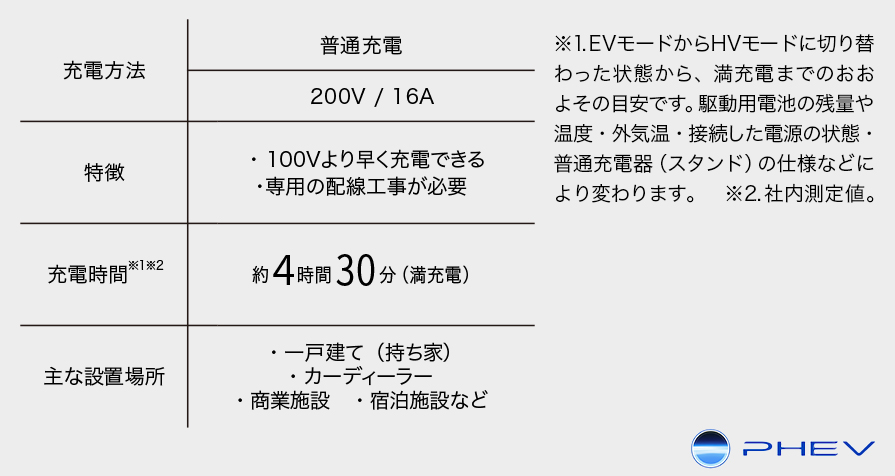

    I am not sure what you are referring to, but the purpose of the OP was to provide charging specs for Gen 4 and Gen 5. It took me sometime to dig the Gen 5 charging specs from the Japanese websites, and I thought people would find it useful. Again, slow/fast refers to charging time (hours) here, and charging power (kilowatts) is not a unit of time as some people wanted it to base slow/fast on it; therefore, I don't think my thread title was misleading.

    At 133 MPGe plug-to-wheels, and 3.3 kW, the Gen 4 charges at 13.0 MPH.
    At 127 MPGe plug-to-wheels, and 3.5 kW, the Gen 5 SE charges at 13.2 MPH - faster, not slower. (However, the XSE and XSE Premium charge at 11.8 MPH, slower.)

    Once again, the charging time in the original post referred to the charging time for 100% battery SOC—not the charging time per mile.

    The standard charging current at 120 V is 12 A (1.44 kW) by default, but you can change it to 8 A (0.960 kW) through your vehicle settings.
    If you install a 240-V charger, you will charge at 14.6 A (at the maximum 3.50 kW capacity of the onboard charger), which is 2.4 times as fast as charging at 120 V, 12 A.
    Alternatively, you can use a 240-V plug adapter with your OEM charging cable without installing a 240-V charger as some people do, which will charge at 12 A (2.88 kW), and it will be 2.0 times as fast as charging at 120 V, 12 A.
