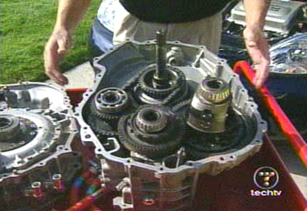

    So in neutral, it is bad to make noises. I guess you should rule out if everything in the transaxle is ok with the wheels and MG2 not moving.. that will rule out the gears in the transaxle. If it makes noise in neutral, could be the diff gears, or even MG2 is bad. (These pics are probably from Gen2, but it is similar.
