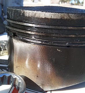

    Most likely the type of oil consumption described in this thread is due to gummed/sludged lower oil control rings on the pistons. Technically this is hard to confirm as it doesn't show with a compression check. The best confirmation is to run some fuel system cleaner and see if it corrects.
    What brand of gasoline are you running? I would recommend Chevron with Techroline or something similar with a cleaner additive like Chevron or Shell.
    To correct the problem you can try adding a bottle of Techroline to the next 5 tanks of gas. This will be a lot stronger amount than what comes added in the Chevron gas and will clean the sludge buildup. The amount of the cleaner that comes added to fuels is only enough to prevent sludge accumulation and not really enough to clean up a substantial sludge buildup.
    This problem may also be affected by an engine that is not ever driven hard. This would be typical of a Prius where you are always trying for high mileage. It doesn't hurt to occasionally get near full throttle redline and this helps to heat and blow out the carbon/sludge.
    I don't really recommend treating a new quart of oil every 1000 miles as an oil change. When this gummed up ring problem is present the oil gets dirty faster and still needs a 5K complete change.
    The technical explanation. An ICE piston has 3 rings, the top 2 control compression, the bottom ring scrapes the oil off the cylinder wall as the piston goes up and down, to keep it out of the combustion chamber above. The cylinder wall is bathed in oil from the crankcase below. Piston rings float in their grooves in the piston so they can closely follow the shape of the cylinder wall, this allows a better seal. Cheap gas tends to contribute to sludge buildup that gums up the oil control ring and groove. The ring gets stuck in one position and does not float in it's groove. This allows oil to get past and burn in the combustion chamber. It's usually not enough to cause visible smoke but enough to burn a quart per 1000 miles.

    Nice advice, thanks for coming back to this. Is that piston in the photo from a Prius?
    - D

    the photo is an advanced level of stuck rings, it probably won't get this bad in a Prius but the rings do stick and start burning oil long before this stage. The photo if from a Google image search but I've seen pistons like this working on Nissan's and Honda's.
