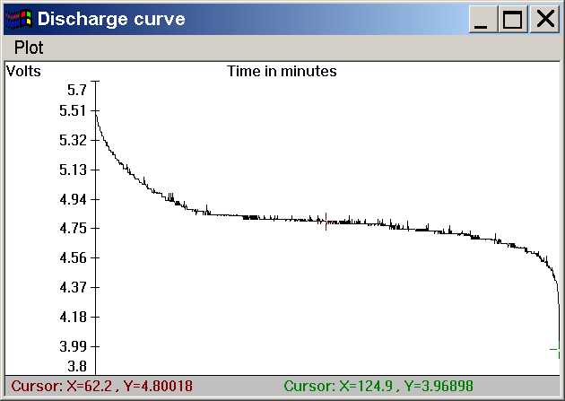

    I've seen other graphs depicting NiMH cells like this. Just looking at an OBDII app. I shouldn't be worried if I see the SOC change increase when charging past 70% or discharging below 45%?
    From what I'm seeing normally between 3 and 6 bars, limited the number of pids per second it shows the SOC change every 0.5% if I were drawing a lot of amps or regen-ing from high speed.
    Where as if I were at 7 bars and the SOC was at 70% or more, the SOC can increase quicker by 1.5% per refresh or second... Visa versa at the bottom end, in heavy traffic with demisters on, etc.
