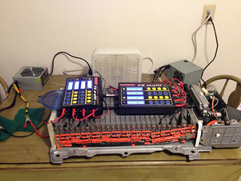

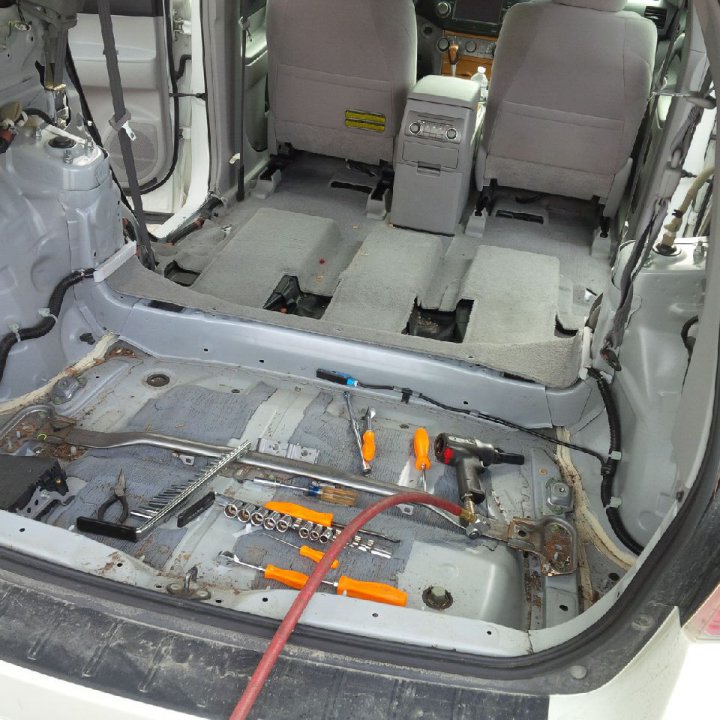

    It's taking quite a while to cycle through all the batteries even with 2 quad chargers (I'm using very conservative settings with 2A charge rates) but I thought you guys might like to see what it looks like to work on a Highlander Hybrid too. I made my own leads from some extra Monster speaker wire I had lying around. One other pain is the battery packs are riveted together so if you need to replace one it's not as easy as just undoing a few bolts. It's definitely more work even getting the batteries out of the car than a Prius, but overall the general principle is exactly the same.
  5. ericbecky
    ericbecky Hybrid Battery Hero
    Mar 12, 2004
    4,452
    3,359
    Madison, Wisconsin
    2amps at a high SOC is not a good idea for these cells. Fun pics though.

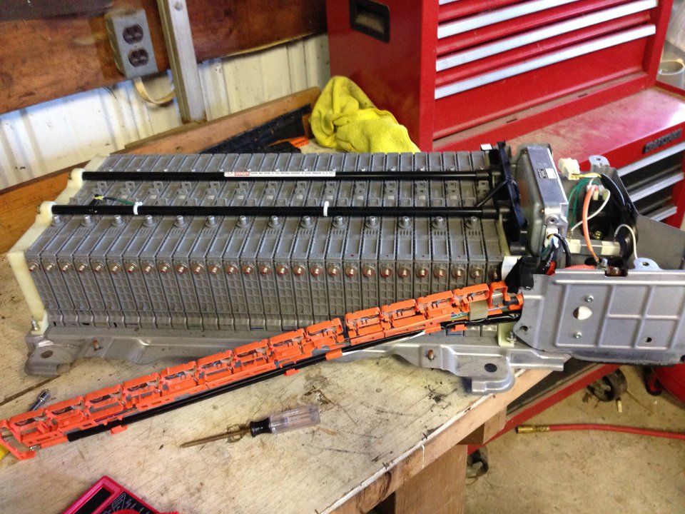

    Initial tear down.

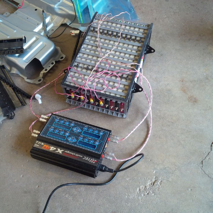

    My charging setup.

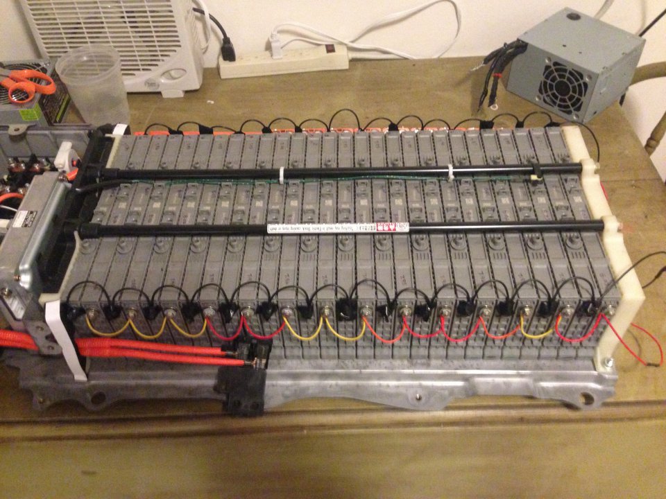

    Final balancing (or so I thought).
