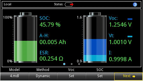

    But my battery equipment of choice is the 2281S-20-6. Can do 20V and/or 6A max. The price is in the $3k USD range. But 6 digits of precision.
