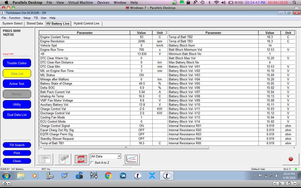

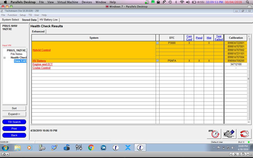

    I’ve had one particular 2008 Prius sitting idle for about two years now, so finally put together a hybrid battery for it.
    And got the red triangle straight away.
    No worries… turn the car off… back on… red triangle.. turn car off… back on… red triangle…

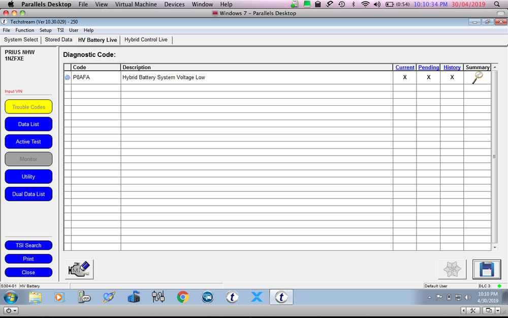

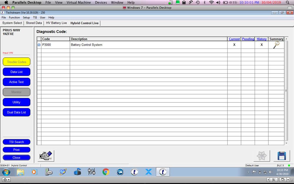

    Time to get the laptop and Techstream out, to find a P0AFA code. Which I’d never heard of.
    Searching through PriusChat indicated that this code has something to do with the voltage harness.
    I assumed that it was a problem with the lower black cable so sourced a replacement.
    It wasn’t until later that I noticed that there was indeed a missing tab on the voltage harness, but that particular tab gets hidden behind the metal tab coming off the black cable.
    You can also see in the lower harness the nickel-plated busbars that I’m using.
    Block 1 was showing a much lower voltage than the rest. Something’s wrong there.
    Revving the engine for a while got the block 1 voltage up but not quite up to the level of the other blocks.
    And then I got a negative voltage. Time to remove the battery and see where I’d gone wrong.
    Ah. Hidden behind the tab for the lower black cable should be a voltage sensor tab. Now I know to double check this in future.
