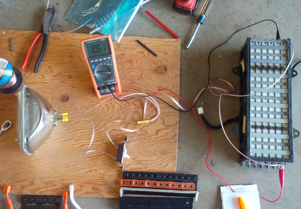

    1) I found the problem and
    2) It looks like everyone should be doing a load test too when rebuilding their hybrid packs!!!
    I've attached a pic of my test setup so people can see what I did and how to build one for testing themselves.
    • Headlight (65w high beam, 55w low beam.....you'll use both)
    • 16 gauge speaker wire (50ft roll)
    • Common wall switch
    • Stopwatch (used daughters ipad, googled "stopwatch online" in safari)
    • Heavy gauge terminals (yellow)
    • Multimeter w/alligator clips (voltage)
    Here's the test results on the packs as promised (each was tested with the 120w load for exactly 60 seconds.......start voltage, end voltage, voltage drop):
    Pack 1 (passenger side, 12 modules)
    10.71v, 10.17, 0.54 <= BAD!!!!!!!
    10.73v, 10.49, 0.24
    10.72v, 10.48, 0.24
    10.72v, 10.48, 0.24
    10.71v, 10.47, 0.24
    10.71v, 10.47, 0.24
    10.79v, 10.54, 0.25
    10.76v, 10.52, 0.24
    10.78v, 10.54, 0.24
    10.75v, 10.51, 0.24
    10.77v, 10.54, 0.23
    10.74v, 10.51, 0.23

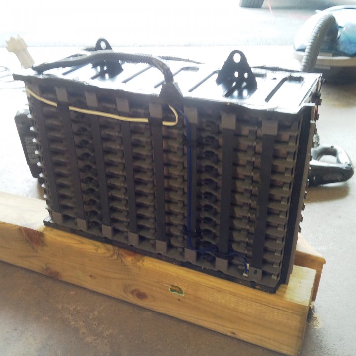

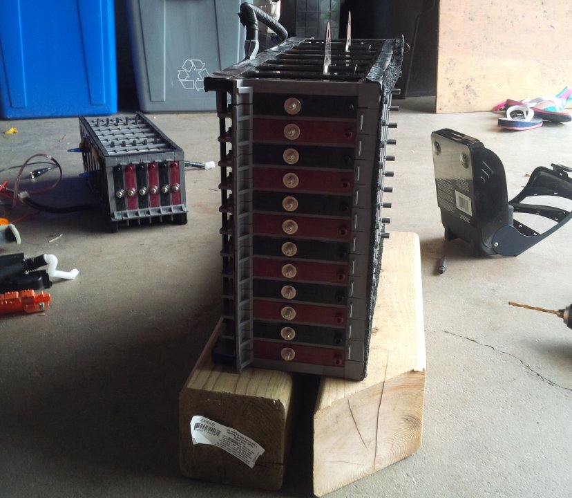

    It's official, my issue is solved. Interior is back in and I got a chance to clean everything in the process. The car has had this weak module since I bought it (got it with 220k on odometer) so I was never really able to experience what a hybrid was supposed to be like and wow it stays in EV mode for a long time compared to how it operated before. Fuel economy has shot back up too.
    Getting the new module in was a bit of a pain on a Highlander because the 3 battery packs inside are held together with rivets. So in order to make them servicable you need to drill out the rivets on one side and replace them with 10-32 machine screws, then tap the end plate with threads to accept the screws. The cross bands also need to be drilled out to allow the screws to pass through. Whatever you do, the rivets are steel so don't use aluminum rivets to put it back together, they are much too weak and may blow apart when the modules are under pressure while charging! I used some heavy pipe clamps to squeeze the pack together in order to get the screws in and used a little blue loctite to keep them from vibrating loose. Other than that just keep everything very well organized and take lots of photos because you'll have a pile of parts to go back in and it's hard to remember where it all went 1-2 weeks later.

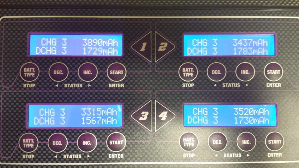

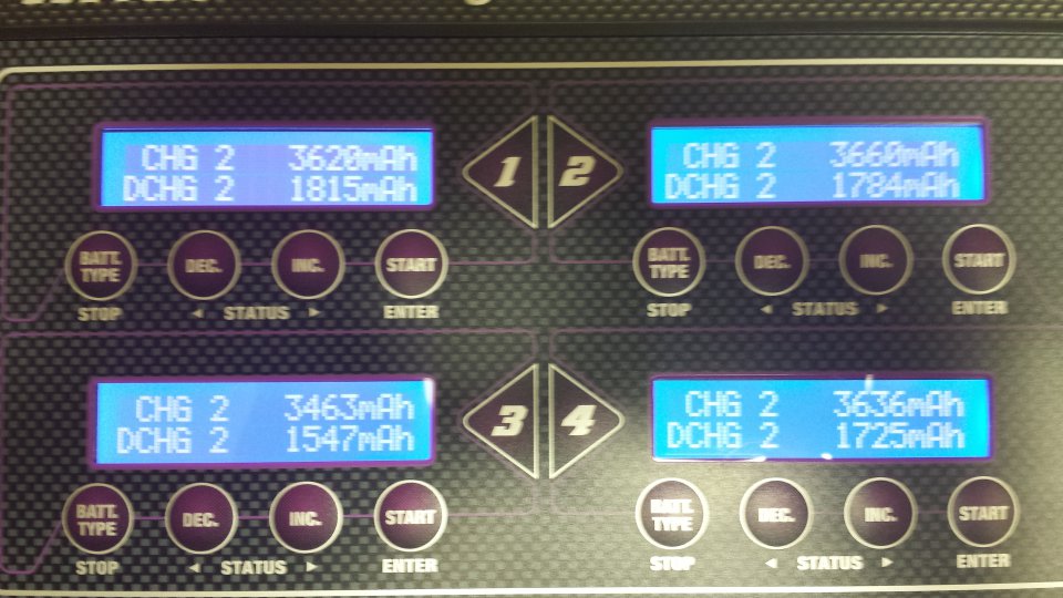

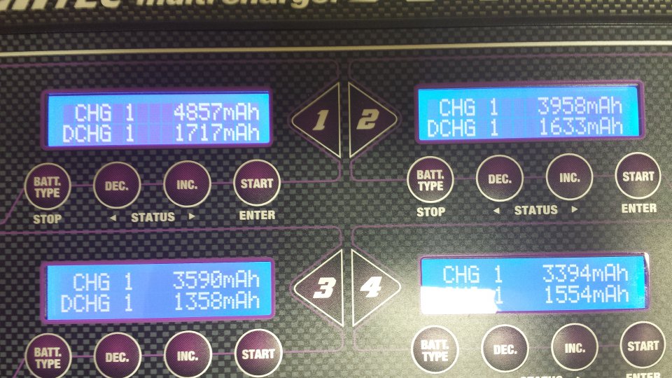

    Yeah my hope was not to buy modules, but I guess these are shot. Heres my numbers on 4 modules. 20140520_213952.jpg 20140520_213931.jpg 20140520_213916.jpg

    Good thing you posted those pics.......something doesn't look right here, those numbers are WAY low!
    1) 1717>1815>1729
    2) 1358>1547>1567
    3) 1633>1784>1783
    4) 1554>1725>1730
    Are you using cheap chinese leads on these? I suspect you may be having the same problem I did when I first did my testing and that is that the gauge on the wire is too small and/or not well connected so it screws up the delta sensing on the charger causing it to stop well short of a full charge. Obviously this is extremely important when your trying to rebuild a hybrid battery pack.

    I completely agree with MTL_hihy about the test leads. You are only injecting about half of the charge you need to inject into the modules to net a good result. Pls reevaluate what you're doing and try again. You need to inject at least 7000mah into them.
