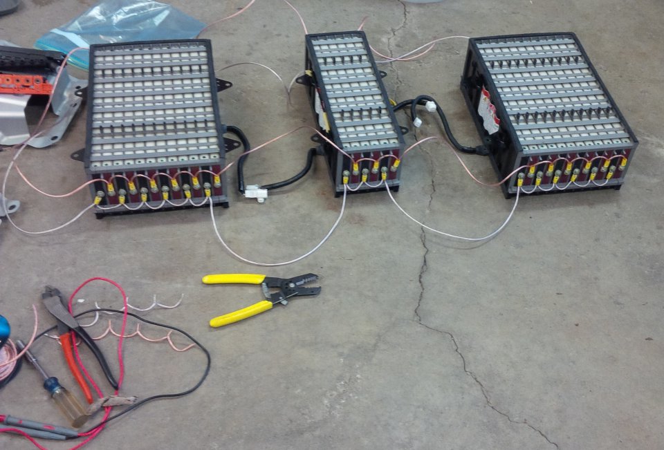

  5. MTL_hihy
    MTL_hihy Active Member
    Sep 2, 2013
    536
    261
    Maritimes, Canada
    The Hitec x4 AC Plus has it's own power supply, you just plug it into the wall and start cycling.
    TowerHobbies.com |Hitec X4 Plus AC/DC Charger
    The zigzag harness is a big waste of wire IMHO, alot easier/simpler to just do something like this (see below).......ring/spade terminals should really be used so you get a solid connection and don't run a chance of stray wires shorting on nearby terminals. Having a good harness also helps if you need to balance multiple times (you can get a box of 50 spade terminals at Home Depot for less than $10). Also if you connect them wrong it won't damage the modules but you will see big sparks (ask me how I know). :D

  6. Michael Hammer
    Michael Hammer Junior Member
    May 30, 2014
    36
    That Picture of how you connect them all together is genius :) I would have zig zagged all over the place and used up 5 times the amount of wire . I already have some speaker wire but will buy some spade terminals thanks for the picture :)
