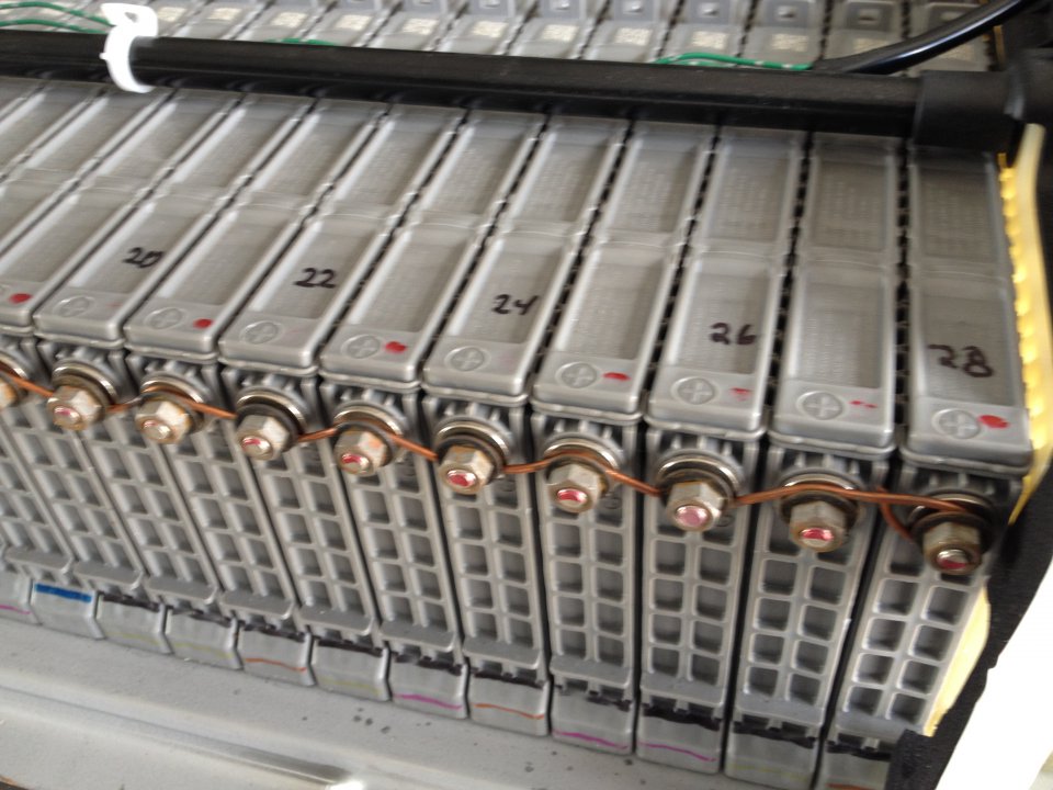

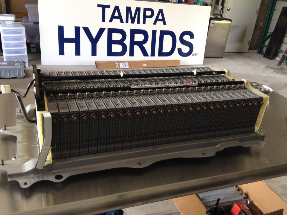

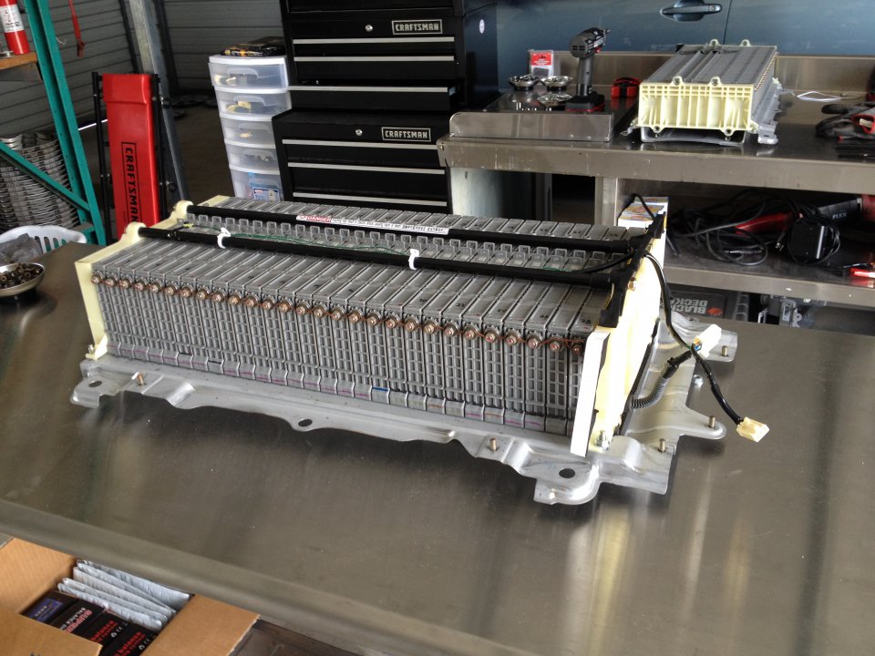

  5. TampaPrius.com
    TampaPrius.com Active Member
    Feb 20, 2013
    461
    300
    Tampa, Florida
    Here is a simpler way to equalize in parallel. I just rearrange the pack in parallel and run a solid copper wire across each side and hold in place with the original bolts. I usually let them equalize for 24-36 hours.

  6. MTL_hihy
    MTL_hihy Active Member
    Sep 2, 2013
    536
    261
    Maritimes, Canada
    Pretty simple, I like it........should work well on both the Prius and Camry (Highlander would be easier to just make a harness).

    So it's simpler to dismantle and rearrange and assemble a pack with the modules lined up. Then parallel balance it. Then dismantle again and rearrange the modules back the proper way?
  10. TampaPrius.com
    Feb 20, 2013
    461
    300
    Tampa, Florida
    I have to dismantle the pack to add the new module(s) anyway. It only takes about 5 minutes to dismantle once all the bottom bolts are out. I don't put them in until final reassembly.

  12. kiwi
    kiwi Member
    Jul 12, 2012
    246
    88
    New Zealand
    Thinking about streamlining the process and making it even faster (guys in Australia were asking an advice as they are doing 5 - 10 packs a week).
    I was about to suggest the same consept of connections but to use flat bas bars instead. Thick round shape wires as on your pictures even in a wave form could possibly be pushed out from under the edge of the nuts , hence - little more prssure and the wire could be pushed out of position. Or perhaps you can flatten the round shape wire - but with the wave form - would it be slower to put on/off without completely uncsewing the nuts?
    Why not using the copper bas bar connectors from old battery packs? They are flat and would be held in better.
    How about making a tailored harness in a shape of a rake to put on/off quickly from the top without unscrewing the nuts completely?

  14. Houston Hybrids
    Houston Hybrids Junior Member
    Feb 24, 2014
    73
    23
    Houston
    If you are doing a large volume of packs weekly and already have the modules removed from the case....just line up modules by polarity and overlap the copper bus bar plates from one post to the next to equalize. This only works if you have extra copper plates (which is typically the case with rebuilders).
    Jessica
