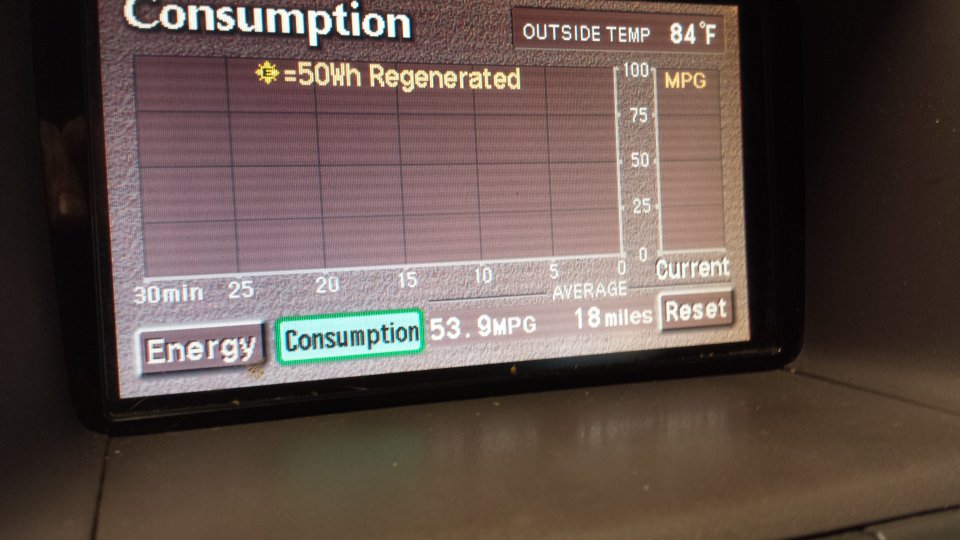

    Update: took the prius into the mountains, got back with no issues. Was 44mpg avg after the trip. Reset my computer to record city only mpg, so far so good! This 18 miles was on 30 to 45 mph streets with plenty of stoplights hit. 20140610_192649.jpg

    2001 Prius
    So im curious if anyone has any input on why with this degraded pack am I getting 53mpg? Could it be that the prius charging system is injecting a far better charge than my bench top charger was, now that the pack is healthy and matched? Or??? Ive put more miles on and we're pretty much right there on mpg still after nearly 50 miles.

    That's great news especially for a first generation pack getting 53 mpg :)

    Great news yes! I just want to know why were in that neighborhood after getting low capacity numbers during rebuild. Hows your cycling going?

    Yeah more chargers make quick light work. It must be a justified investment in your case. After all, time is money. I disabled time limits. The charge limit will cutoff before the time anyway. Mine were delta peaking in a way that prevented balancing but hell I must have done something right at 53mpg.

    53 Mpg is not unheard of in city driving for a Gen I (esp without ac use). Do this once, drive a steady 45 mph (engine on) on a flat surface and you'll find the instant mgp readout is above 50 (usually closer to 60). The car is a city car and the "C" is its direct replacement. They basically improved on the Gen I and made the "C".
    Additionally, you don't really need that much capacity to benefit from the hybrid system. The real benefit to HSD is regen braking/coasting. Charging the battery with the ICE is actually a loss of energy. Charging it with regen and using it to take off/maintain speed is using energy other cars simply waste.
