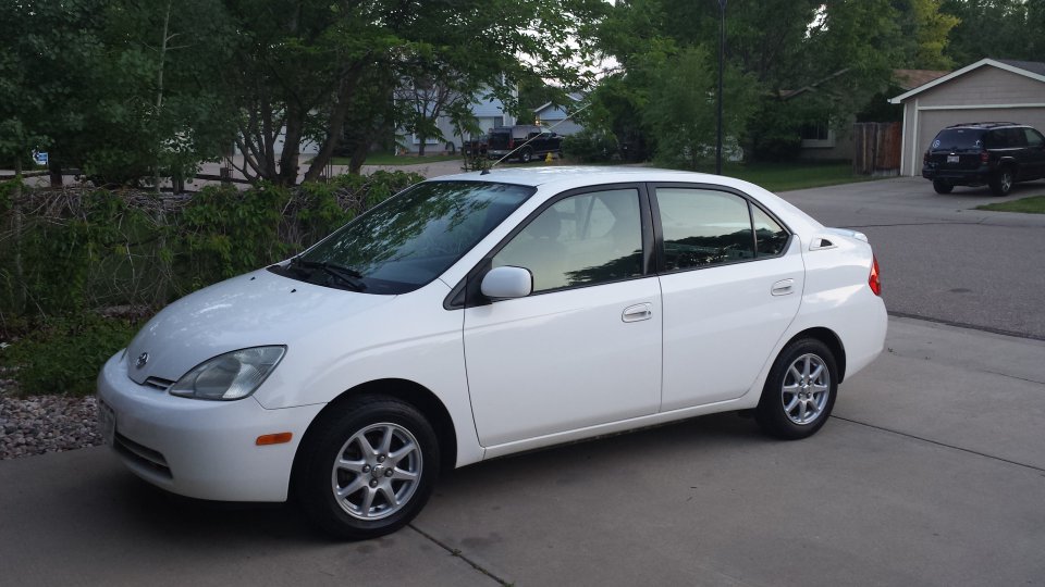

    Heres what my 53mpg gen 1 looks like, after much effort... 20140612_201109.jpg

    She's a beauty. :)

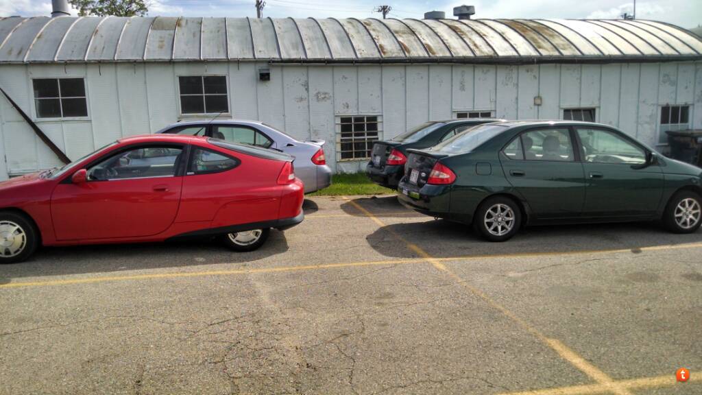

    I have three sitting in my shop's parking lot right now. They look so happy grouped together! Each had different issues, but now they are all purring along nicely.
