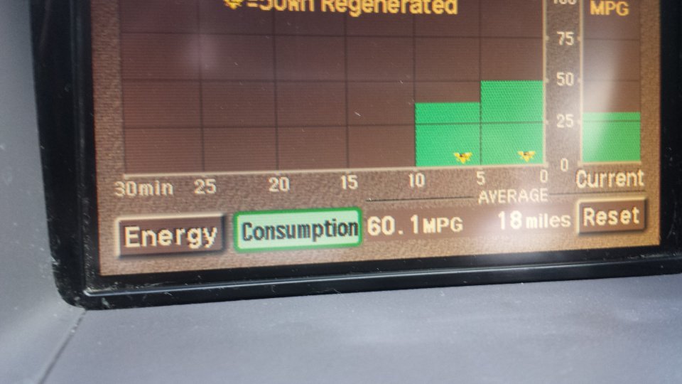

    20140616_183456.jpg All looks good to me, my charger had a max 2 amp discharge rate. The charger will only do this on the right module, probably an rc battery with less cells or something. With the setting at 2, mine were floating between 1.0 and 1.2 discharge rate. Just have confidence the charger knows what its doing.
    X2 on what MTL said, turn the timers off, let them max or delta. And your max is fine. Many go to 7500, I conservatively would have gone 7000 to 7250 had my modules even taken it. Looks like your on your way to a good pack though. See my previous posts on this thread, 53mpg on a degraded pack. Key to my success was matching and eliminating modules with bad cells I guess. Didn't get much balancing. Oh and heres one 18 mile average after a reset from the 50+ avg. This is also after a learning curve on how to drive a prius.
