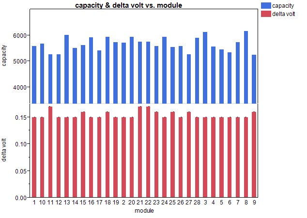

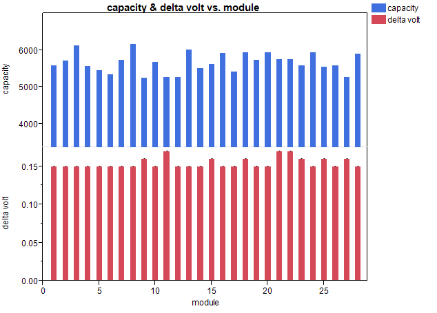

    After rebalancing and charge equalizing all of my modules I have the a pack that looks like this.
    The capacity is the final discharge capapcity of each module.
    The 'delta volt' is the voltage drop after 1 minute with a 55w headlight.
    Should i re-arrange the modules to even out the capacities? And do I need to discharge the modules before re-installing?

    Evening out capacities is not the best strategy as the capacity of a pair of modules in series is determined by the module with the least capacity. A goo strategy is to load test each module (use a standard auto headlamp) as you did to determine the voltage drop when the load is applied (any module that exhibits a large "Delta-voltage" under load should be replaced). Then pair up modules so that all of the pairs exhibit the same total drop under load. That will minimize the chance that the battery ECU will see a significant voltage difference between module pairs and set an error code.

    Thanks for the replies. Since most of my voltage drops were 0.15, with only a few at 0.16 or 0.17 I can't do any better by re-arranging them. What about discharging the modules before re-installing. I read somewhere that if the modules are too charged it will generate an error code. After equalizing the pack by connecting all of the neg and pos terminals, each module is now at 7.90 volts. Is this too high?

    AS MTL-hihy noted, do the load test for a few minutes (same period for each module) and use a heavier load current (he used both the low and high beam filaments in parallel) to get a better reading on your modules. Note that this will also discharge the modules a bit to not generate an error. Remember to re-equalize the modules by putting them back in parallel after the load tests.

    Good to note this as well, don't put full charged modules back in or you will get an error from the hybrid ECU. You want to aim for around 50-60% charge (between 40-80% is fine, nominal 7.2v = 50%) and balance voltages in parallel again before install. So 7.9v is a little on the high side, I would run some better load tests and drop them all back to around 7.2-7.6v, re-pair modules based on better load test results, then re-balance everything again and do your final install.
