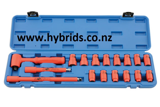

    FYI: Class 0 (up to 1000V) is recommended by Toyota (Class 00 is up to 500V)
    "Kitchen Gloves" are usefull to protect skin from chemicals when you are cleaning bus bars and nuts (you may use Boric Acid as recommended by Toyota) or for the "fast and furious" cleaning of the bus bars - experiment with Phosphoric Acid (at your own risk)
    As for the socket set - I use insulated set - up to 1000V, see below:

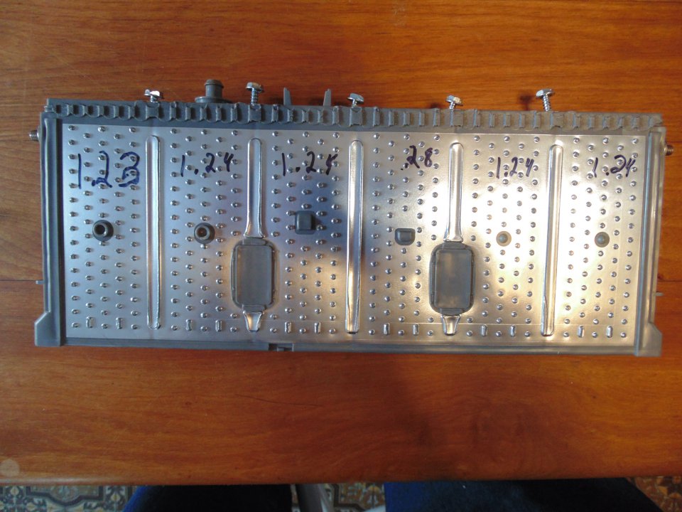

    Today I started an experiment to test what is happening to the cells within a module during rebalancing charge and discharge cycles. This was a junk module before I put the sheet metal screws in. The screws contact the cell interconnects. We can now measure individual cell voltages and capacities. The modules resting voltage is 6.60 volts. I have always rejected modules that self discharge below 7 volts. I have hundreds of junk modules to subject to testing. I am open to suggestions for tests to be done. If someone else would like to try some tests and share their results I will send them modules at no cost. If we learn anything from the junk modules I might be willing to sacrifice one or two good modules.

    what you have observed (one cell is dead and 5 still not) - I regularly see during first few minutes of tests on my HV Analysers. Those bad modules behaviour is always the same: voltage drops abruptly during DSCH on those modules which have dead cell(s) inside. If it is CHRG cycle - it raises to above threshold levels quickly.
    Was recently testing NIMH 8-cell cylinder type cell pack from specialised equipment (it did not hold the charge although have not been used much) - when dismantled - there were 2 dead cells out of 8. That pack was rearranged to 6-cell module to be used somewhere else. Then tested 6 cell pack on HV Analyser J by connecting each probe to 1.2V cell simultaneously all under one load – capacity was very good.
    That condition is non-recoverable. You can’t change one dead cell in those Prius plastic modules.
    You can’t revive them by cycle charge. That is why trying to rejuvenate one pack at a time without having many extra modules to choose from – is never geared for success.
    Still good modules with partially lost capacity (age, mileage) are behaving differently under load down to 6V - discharge curve does not have the "steep cliff" – it is always gradual decrease during discharge or gradual increase during charge.

    Alternative to gloves in some situations could be special socket set - I posted photo of the insulated socket set I've got for myself - it is up to 1000V (made in UK). Toyota also recommends insulating mat to stay on.
