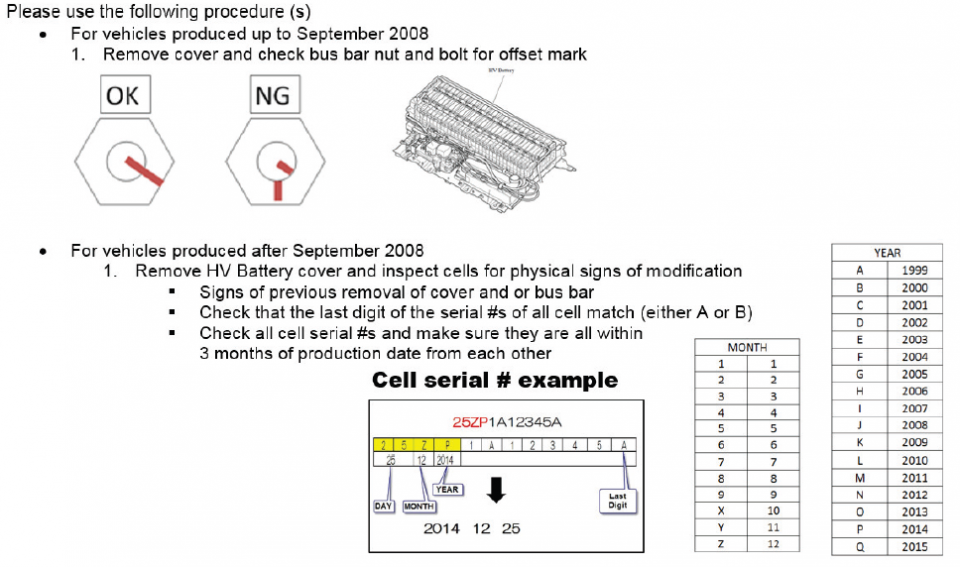

    Use this chart to find manufacturing date of modules so you know what you are purchasing while searching for modules on eBay.
    Ask for mileage/serial numbers and/or ask sellers to take pictures of serial numbers if they can.

    So from what I read today, just driving it and accepting the reduced performance isn't going to work for long. Apparently it will eventually go into a real limp mode?
    Thanks, good reference. I have the equipment at home to hobble together a system to do the same thing the HA Prolong does. Besides, I'm a little leery about a product that brags about its high quality then presents a 2x4 mounted light bulb as part of its solution :)
    Good reference on the cell dates. So is Ebay the preferred supplier of individual cells?
