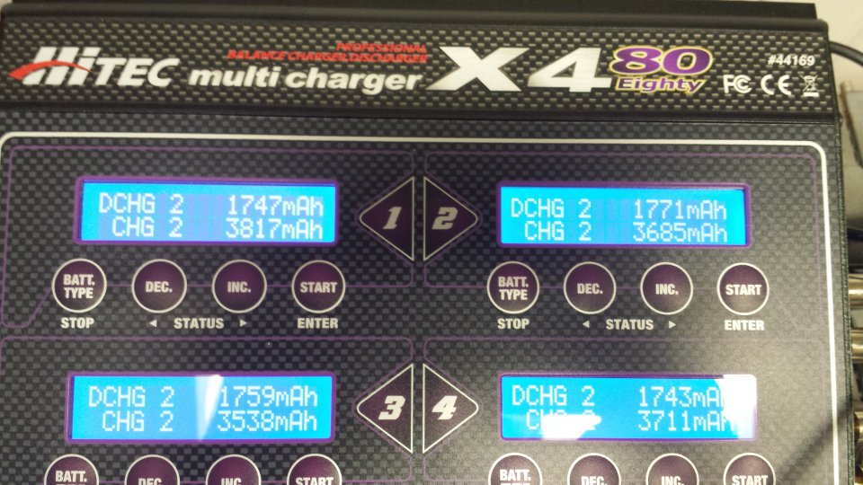

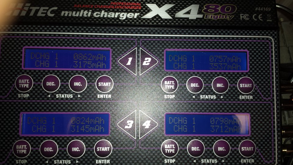

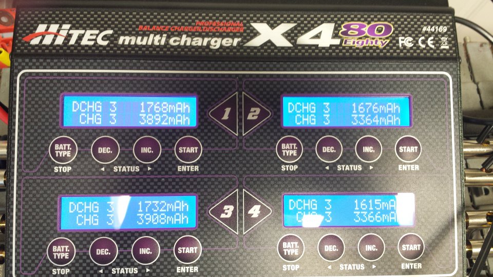

    No that wire harness was just to balance the voltages on the modules before I put them back in, it was not for parallel charging. The X4 will do 4 modules at a time and you want to make sure modules aren't getting overcharged at higher currents....if you are grid charging at low current (under 1/3 amp at 240V) then overcharging is much less of an issue. I had 2 Hitec chargers doing my pack to speed up the process but just one will certainly do the job as well. Remember load testing is one of the most critical steps so keep charging current as low as possible (2A max! pref 1A) and discharge as high as possible for best results.
    Settings:
    Prius Battery rebalance thread | PriusChat
    #1966 MTL_hihy, Sep 1, 2017

    I agree with your statement because I have used the prolong charger on my battery many times and clearly they are not all going to be at the same voltage and it didn't seem to matter when the vehicle started. It does take a little while for the vehicle to manage the voltages after the grid charge but I wouldn't bother with building the harness again. Grid charging (whole pack) / load testing really is the best method anyway but grid chargers are expensive to get the equipment so if you are on a tight budget it may be out of reach.

    I found exactly the same thing.........this is why load testing is critical in the rebuild process.
