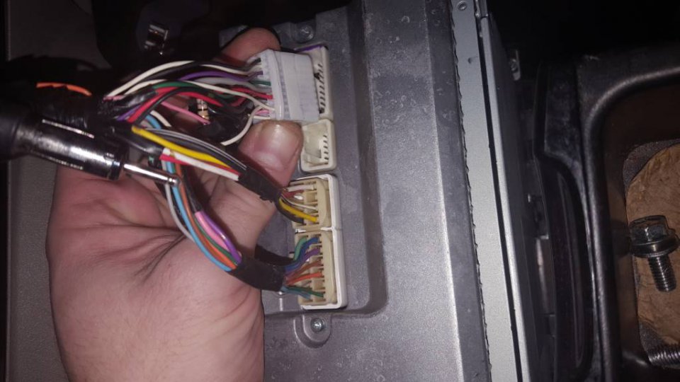

    [​IMG]<br /><br /><br />The illumination is controlled by this plug on the back of oem radio that. This is where the steering wheel control wiring is. Well got it figured out just need to do some wiring lol<br /><br />Posted via the PriusChat mobile app. 1514486242192.jpg

    This was how I wired the controls and lights up for the android head unit no other harness was needed it was built into the radio controls.
    SlickAce and R-P like this.

    This thread is a bit old, but I am having issues with my steering wheel backlights as well.
    From the previous post, it would appear that one of the circuits in the above post affects the backlights. I installed the resistor as per the instructions between the white and pink wires of that harness, and all of my climate controls work. I can't make heads or tails of the wiring diagrams, does anybody know what I need do here? My plan is to only keep the car for a year or so, and I'll be reinstalling the factory head unit when it sells. So I don't want to chop up the factory wiring any more than I have to...which is why I'm foregoing the steering wheel controls.
