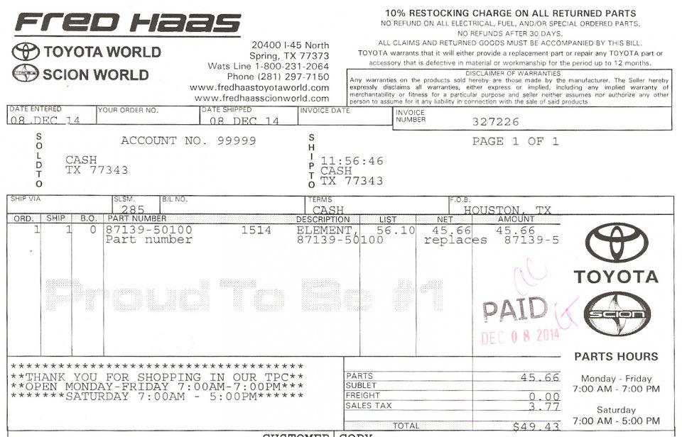

    Doing maintenance on our beloved 2013 the stealer recommended to clean and or replace our cabin filter at 15K miles. I elected to purchase a new one. I did remove the OEM factory filter and found a few leaves and quite a bit of dust. I proceeded to blow it out with compressed air. The filter looked great, but decided to replace it anyway. I went with a OEM filter, but also opted out for the more expensive Carbon Filter. Below is a copy of the invoice which shows the price and part # of the filter.
    Hope this helps everyone in their ongoing maintenance of their Prius!

    Ouch! I bought the same filter on Amazon for $29.02 Prime shipping 3 days ago. Installed it yesterday and took all but 3 minutes.
    FuelMiser and dorunron like this.
