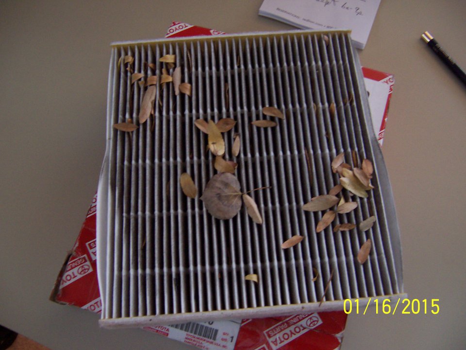

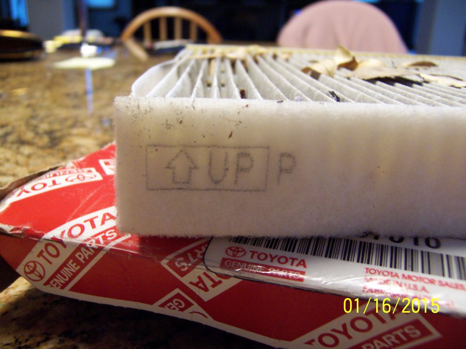

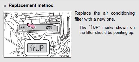

    This is the original cabin filter after 1-1/2 years and 20K miles per the original owner. The OEM has an arrow and the word UP printed on the end that shows after you insert the filter into the housing. The only other thing I will add is that releasing the side tabs on the Gen III glove box was extremely difficult compared to my Gen II. The glove box is a lot more rigid, and the sides do not bend inward to release the tabs.

    Yeah, that's what I was thinking.

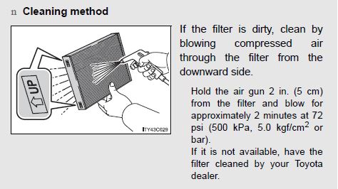

  14. Mendel Leisk
    61,452
    42,293
    The current manual suggests to clean it with compressed air, or replace. That's actually a first for me, I don't recall previous Honda manuals saying that.
    The first pic above obliquely explains the air flow direction: downward.
  15. GregP507
    GregP507 Senior Member
    Apr 5, 2014
    3,002
    481
    Wow! A blast from the past.
    I wonder how this one got by the business analysts?

    320
    I took my car in for the first 5,000 mile inspection and when the Toyota mechanic checked the cabin filter he put it back in with the arrows and UP pointing down. Makes me wonder what else he did wrong. Now, I'm almost due for the free 10,000 mile oil change. I dread that.

    Yes. The direction of flow is extremely obvious anyway, considering you can see the intake side of the fan directly below the filter.
  18. RRxing
    RRxing Senior Member
    Jul 7, 2009
    2,562
    1,839
    NEPA
    Agreed, it is quite obvious, since when you remove the filter all of the debris is on the TOP of the filter, so we can safely deduce that the air flow is from above to below.

  20. Mendel Leisk
    61,452
    42,293
    Well, since everyone else is responding:
    It's not that obvious to me. I don't think I even noticed a fan, the light wasn't that good. And fan location doesn't determine air flow, air flow through a fan could be in either direction.
    I'd suspect the filter would work in either orientation when new, but obviously you don't want to accidentally flip later on. For that reason, an orientation label "UP" is better than "AIR FLOW", less ambiguous.
