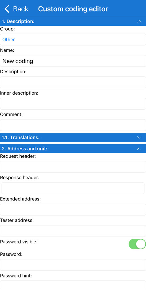

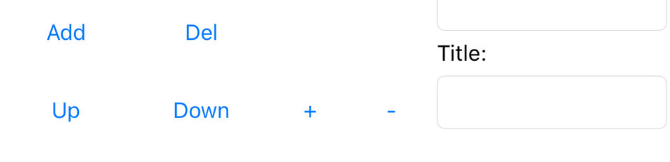

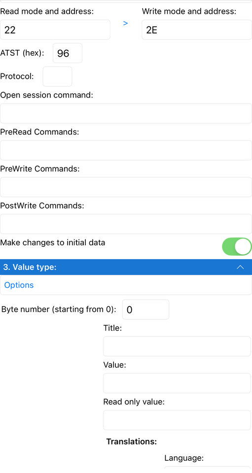

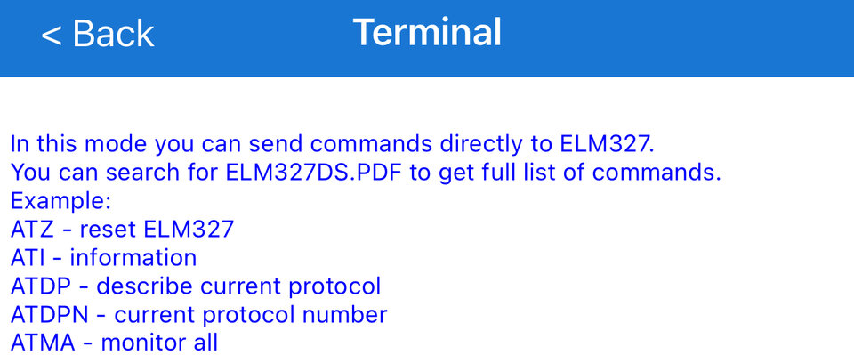

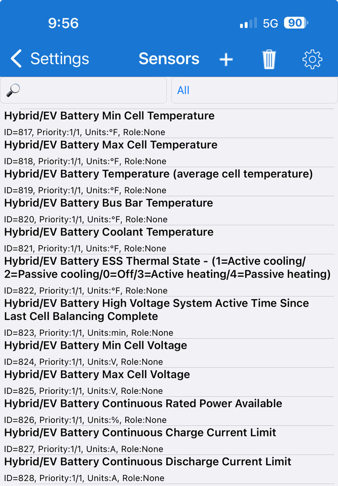

  11. rjparker
    rjparker Tu Humilde Sirviente
    Jun 6, 2008
    11,135
    6,984
    Texas Hill Country
    I use Car Scanner Pro and find it convenient since the bluetooth adapter and phone are always in the car. The points are easily configured into graphs with multiple points overlayed if desired. Many "dashboard" templates are preconfigured and easily modified. Prius hybrid battery data is all there as well.
    However for bidirectional control and assurance that all points are working, I go with a hardwired PC laptop Techstream scanner or a dedicated Launch scanner.
    There are no standard bidirectional controls in Car Scanner, although "Custom Codings" apparently can be created and saved in the current 1.121.0 version.
    New features include configuring user and "dealer" configurations such as how the light and lock timings work, etc.
    Some of the basic ecm data points for the gen3 profile like engine water speed rpms are shown but don't work. Several messages to the development team provided a "it's there and works". Meanwhile the inverter pump rpm does function along with hundreds of other points from ~20 ecus.
    It is likely the developer has fine tuned gen2 points more than gen3's.
    One complication is the developer's attempt to cover all brands and models in one app. There has to be some that are more comprehensive than others.
    With that said, Car Scanner Pro's ability to see most points and dtc's make it worth having in the car.
    The newer Terminal and Custom Codes are supplemented with a long list of sensor IDs and an editor of sorts, all of which I have not tried.
    Example Sensor id list
    Custom Coding Editor

  12. ChapmanF
    28,750
    19,055
    That right there is what I'd like to see more about. The review three years ago confirmed usability with two ECUs. There's nothing in the screenshots above showing any others.
    The Custom Coding Editor screenshot shows something like I expected: some blanks to fill in that will be enough whenever the necessary communication can be accomplished by putting the right stuff in that particular selection of blanks.

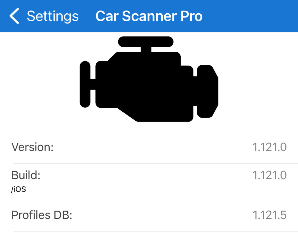

  15. mr_guy_mann
    mr_guy_mann Senior Member
    Sep 3, 2020
    4,120
    2,018
    NJ-USA
    I just updated CarScanner (ver 1.121.0), and can't really see much difference from my earlier review.
    Connected to my 2006 via OBDLink MX+, and had it scan "all systems" for codes. It checked 131 possible ecu's and reported "no codes" but only had: OBD2, engine control #1, hybrid engine system, and HV battery as the ecu's detected.
    Going to "All Sensors" gives a data list for OBD2 - Toyota (but not Prius) specific ECM, and hybrid control - HV battery ecu.
    That's all I find "out of the box". Yes, you can get a bunch of ecu identifiers for many other systems, but no codes or data, so what's the point? If I'm overlooking something, please let me know.
    Maybe the custom coding option could let someone do lots more, but for me I'm going to stick with the other options such as Autel.
