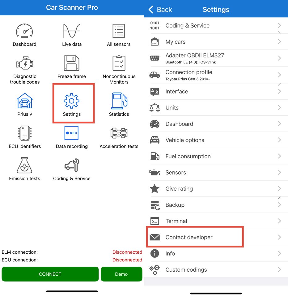

    (How) did you forward this to the developer to correct?
    How do the other scanner measure pump rpm (likely same PID) could help this lone polish soul.

    In the app
