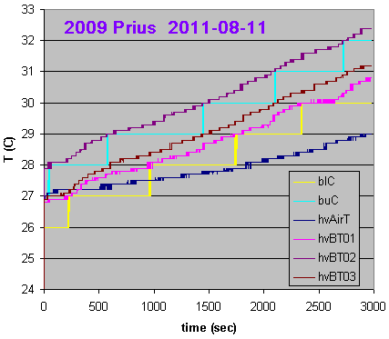

    Just to follow up on the HV Battery Temp. Since I drove into work today, I parked under the sun. During lunch time when I started the car, MFD reported 91 deg F outside temp. The HV Battery Temp read 106 deg F. I checked the HV battery air intake temp and it was also 106 deg F.
    So I checked the HV battery fan speed. It was at 1 lowest speed (0 = off, 6 = highest). I turned on the AC so the HV battery could intake cooler air but to my surprise, it did not change probably due to a short drive. I drove about 1 or 2 miles to get lunch and the battery temp continued to raise. When I got back to work, the battery temp got past 111 deg F (pic below) and the fan speed increased to 3. I still could not hear the fan so I went to the back and listened carefully and then I could.
    Interesting geeky stuffs. :D

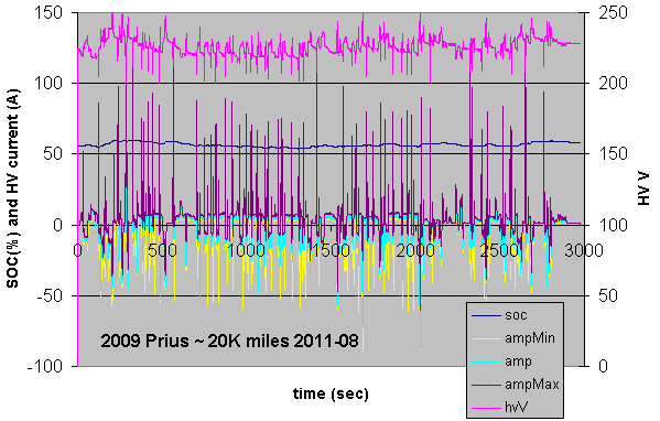

    At about 20K miles I am not too worried but am not completely happy about the HV battery either - one of the module appears to be weak:
    Here are time graphs of a recent data set:
    Now it would be interesting to take a look at the data from your car and compare. You still have PriiDash running, right? Just take a look at one of the csv files or send me the file and I will make graphs.

  13. 2009Prius
    2009Prius A Wimpy DIYer
    Mar 25, 2009
    2,705
    512
    63
    Good idea!
    This time the HV battery had some real exercise (plenty of regen and power assist currents) so we can get meaningful data:
    The HV battery seems to be in good health (no explicit or implied guarantee or warranty whatsoever! :)). Some blocks are ever so slightly weaker than others but they don't differ much:
    2 people like this.
