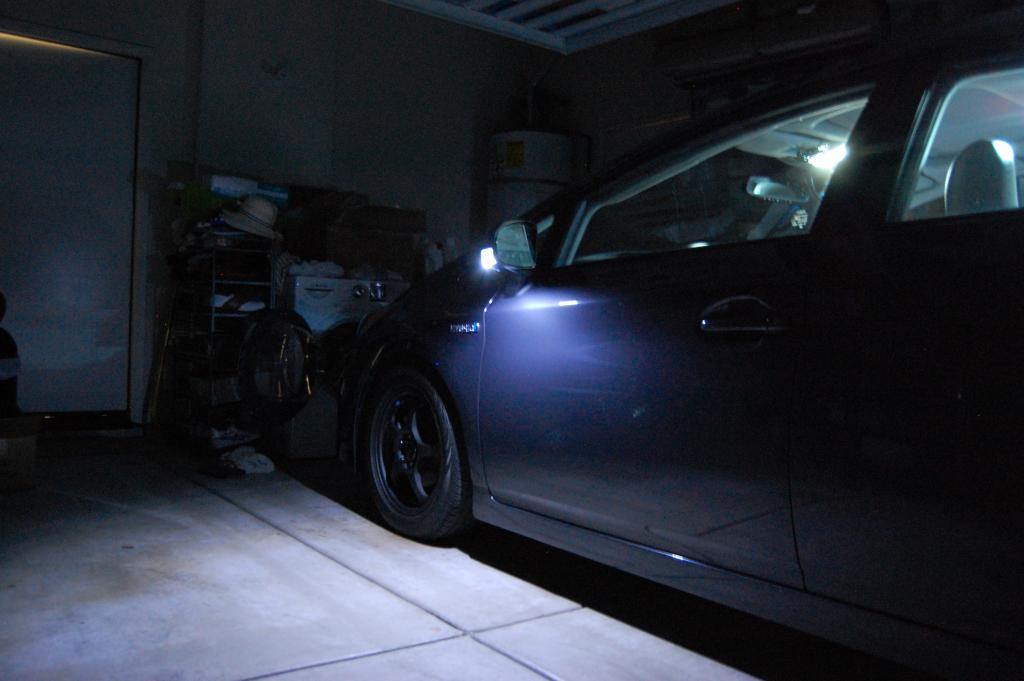

    Anyone attempted doing this? Wiring in some lights under the side mirrors to turn on with dome lights as the car is unlocked - or when the smart key is sensed and the interior lighting comes on?

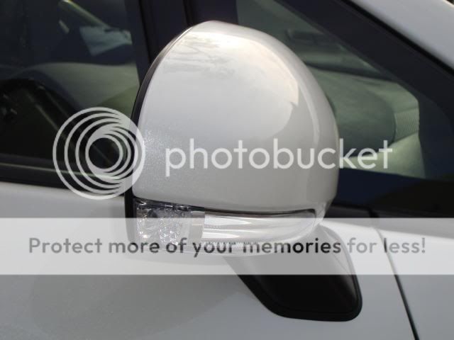

    I know the Gen3 has it and you can order the turn signal mirrors for the Gen2 and they have it...but I don't want to spend that much on turn signal mirrors.
    Also..best place to connect the wiring? I keep hearing of a 'magic blue wire' - any advice?

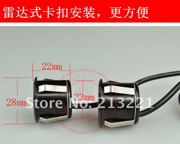

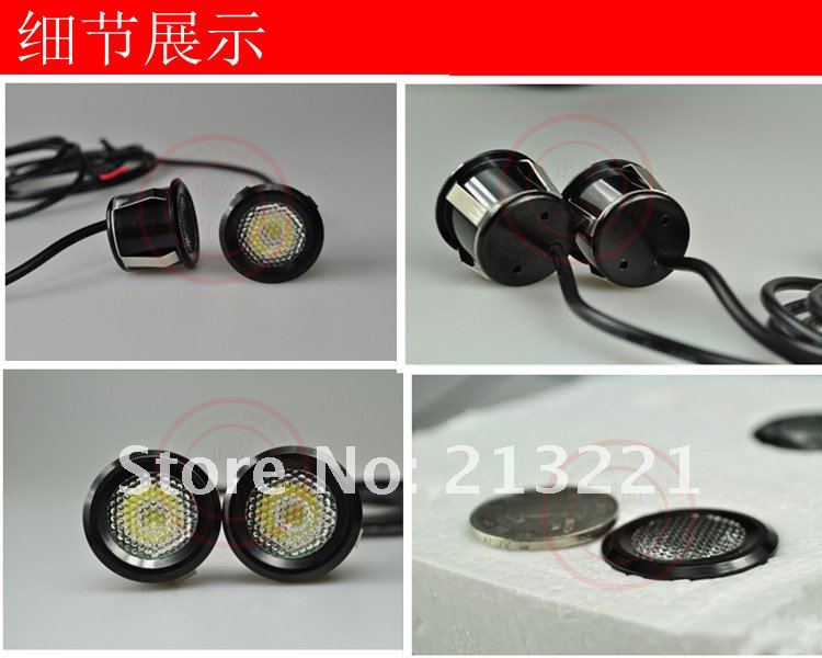

    Found these: Aliexpress.com : Buy New !!! 9W High power IP68 DRL Daytime light Reversing Radar shape Eagle eye Led Rear backup tail lamp Full Aluminum body from Reliable daytime light suppliers on Easylink Technology Co., LTD
    A month later or so - they arrived. Installed with a 15/16 wood circle bit.

    One Nice thing is they are waterproof...so I'm not concerned with moisture getting into the side mirror. Pretty bright on initial testing...

    Plan on it. Currently the LEDs are mounted in the mirrors and the wiring is rounted thru the mirror into the door, but I haven't routed the wiring thru the door thru the rubber wire loom into the cabin.
