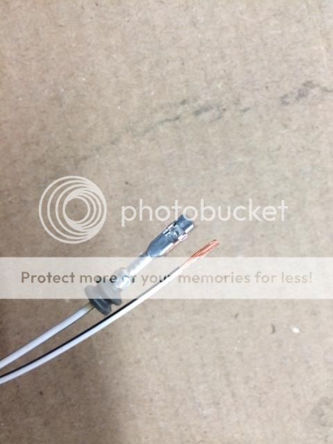

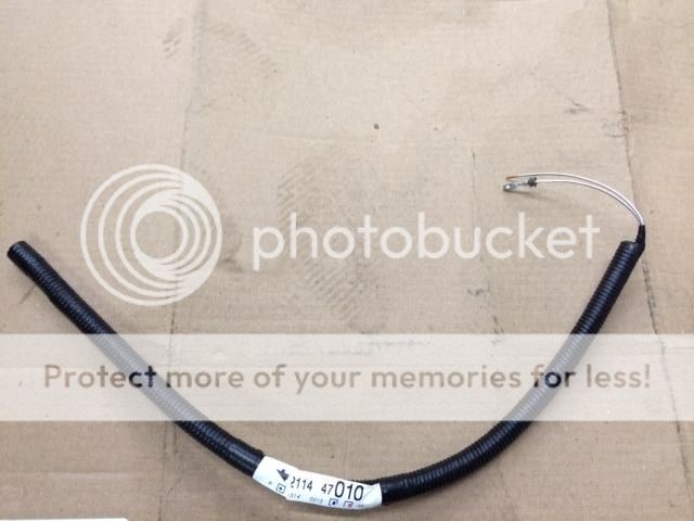

    I reviewed the TSB and realized that this wire is being added in series with the original headlight power wire, so Toyota's TSB fix is to reduce the voltage fed to the H11 headlight bulb, not increase it. It appears they're adding about four feet of the very skinny wire, and without knowing what gauge wire it's hard to guess how much voltage drop this fix creates. They could also be making the bulb connector more robust with this TSB wire than before.
