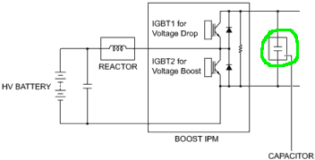

    Get the Park linkage retracted and you can go ahead and power the car back down if you want (if you unplug the Park motor first so the automatic return to Park on power-down can't happen), and the car, needing no power, rolls around pretty much like any other car you ever pushed around in neutral.
    You have to lean a little extra hard to start it moving, because this capacitor is normally at 0V when the car's off, and your initial shove puts a charge on it from MG1:
    It's not all that big a capacitor, so your first shove brings it pretty quickly to a voltage matching MG1's, at which point current flow ceases and the car's no harder to push around than any like-sized car in neutral.
