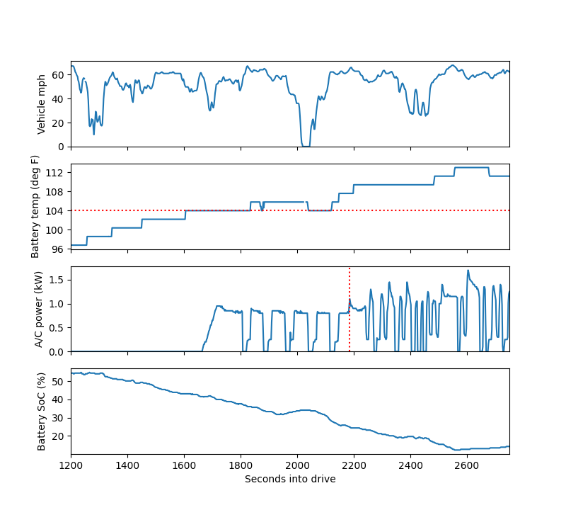

    Attaching a recording of my drive. You can see I start out on local roads, with the windows open and no AC (enjoying the nice weather!), get on the highway, and as the battery temp gets up to 104 F (40 C), the AC compressor starts ramping up, and then goes into that weird cycling mode. That cycling continues after I run out of charge and go into HV mode.
    Weather outside on this day was between 78 and 80 degrees F (26 C ish)
    Unfortunately my scan tool doesn't seem to be able to pull any of the interesting data from the heat pump system. No EXV positions, temperature readings, or anything.

    I didn't pick up on the fact that you provided a new graph that now included SOC and speed and a longer sample time. That's now more interesting data and I'd say sure I'd no doubt notice the temp swing too in the cabin if I saw my A/C power consumption just switch from gently staying in a low 0.5kW consumption mode (what my norm is) to abruptly swing from 0 to 1kW like that and never recovering. And just seeing how it dropped out of EV mode and brought the engine into the mix brings all sorts of new possibilities. Might throw in a look at the HV battery V and Current just to see electrically how they're behaving during that transition. But that's surely something weird there.

    It went into HV at the end due to running the SOC down, so that part’s normal at least.

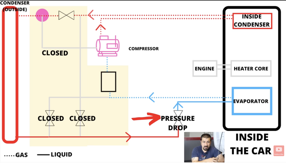

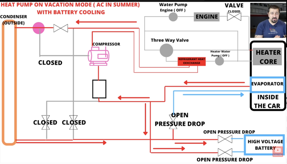

    Semi-crazy theory --
    I don't have the refrigerant diagram for the gen5 Prius, but the gen4 routes hot refrigerant first to the cabin condenser, then to the external condenser's expansion valve (which is fully open in cooling mode, no restriction.) As far as I can tell, the only reason it doesn't heat the cabin when not intended to is because the blend door blocks it off (same as the heater core).
    So I'm wondering whether what I've observed occurs because, for some reason, the blend door is not on full cold (maybe because I've reached target temp and it's tempering the cold air a bit), and when the refrigerant flow increases to supply the battery cooler, this increases the heating effect of the cabin condenser -- and it's just not well-calibrated to cancel it out with blend door operation.
    I'll have to see whether turning the temp down changes the effect. Unfortunately, even though I know these PIDs are there and can be read by a Techstream, my scan tool doesn't seem to be able to read all the gory details off the HVAC, like blend door position etc.
    The gen5 Rav4 Prime adds a battery refrigeration circuit but its heating is a bit different, so including that as well.

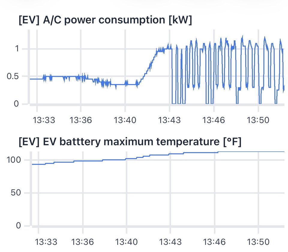

    Alright, did some testing. Ambient temp about 74 degrees F. Took it on the highway with the HVAC fully off (not just the "A/C" switch).
    The compressor did indeed come on when the battery was 104 degrees F (it looks like number is reported as integer degrees celsius, hence the stairstep of the graph.) It seems to cycle approx. every 80 seconds.
    At about 2200 seconds (annotated with red line), I turned on the AC, I believe it was set to 72. You can see that things go a little nutty around then, and that it happens well before the switch to HV mode, and persists after the switch to HV mode. So I don't think it has to do with what mode it's in, just whether the battery cooler is on.
    At some point into the drive, I turned the temp all the way down to LO. Unfortunately I didn't record when, but -- it didn't really change the behavior. Compressor still cycling, and definitely noticeably blowing not-cold air when the compressor cycled off.
    When I arrived back home, I stayed in the driveway and turned the AC off. The compressor returned to cycling at about an 80 second interval. Turned back on the AC, and it returned to behaving erratically. This section isn't in the graph (boring!)
    @LRO If you have the ability to monitor your battery temp and your A/C wattage, I'd be very curious to see what yours looks like, if your driving cycle ever causes your battery to need cooling. It might not take highway driving like mine needed, especially if you're in warmer weather or drive after L2 charging!
