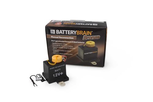

    I figured the safest way to deal with this 12vdc battery "problem" was just to buy and install a "Battery Prog Brain T1" unit from Amazon. It protects the battery from discharging below 11.8 vdc by disconnecting the battery from the car if the battery goes below that set voltage. So if you leave a door open, leave a light on, or park at an airport for too long, it disconnects the battery from the car, at 11.8vdc. All you have to do to get going again is press the reset button on the unit, (attached to the battery), to reconnect it to the "reserve power" that remains in the battery to start the car. It monitors the battery voltage for you, all the time so it will also let you know if your battery is getting too old, and weak so no need to check it with a volt ohm meter. I guess my question is, if it disconnects your battery, say at an airport, I guess you would use the manual emergency key to unlock the car, press the button to reconnect to the reserve power, but would this reset any of the Prius electronics, or cause any problems?

    I believe the worst that could happen is you would lose your presets like nav addresses, trip odometer readings, clock settings, auto window up, and some miscellaneous stuff that the ECU's record as you are driving. IMO, it would be no different than disconnecting and reconnecting the 12 volt when you change the battery.
