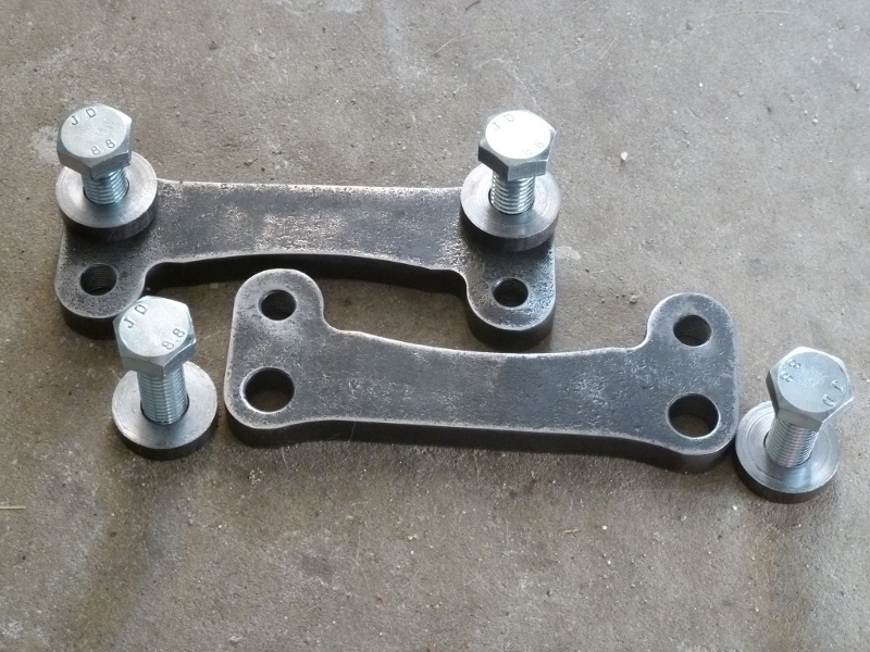

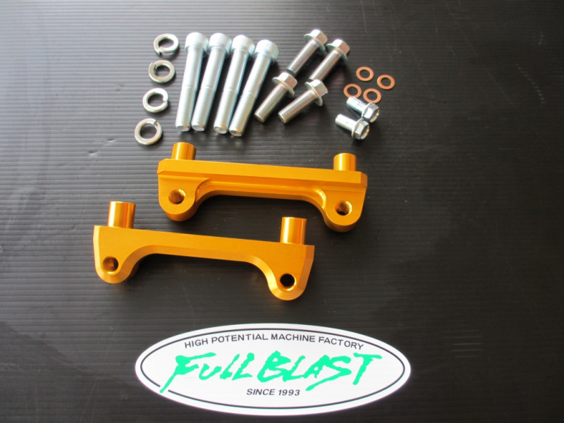

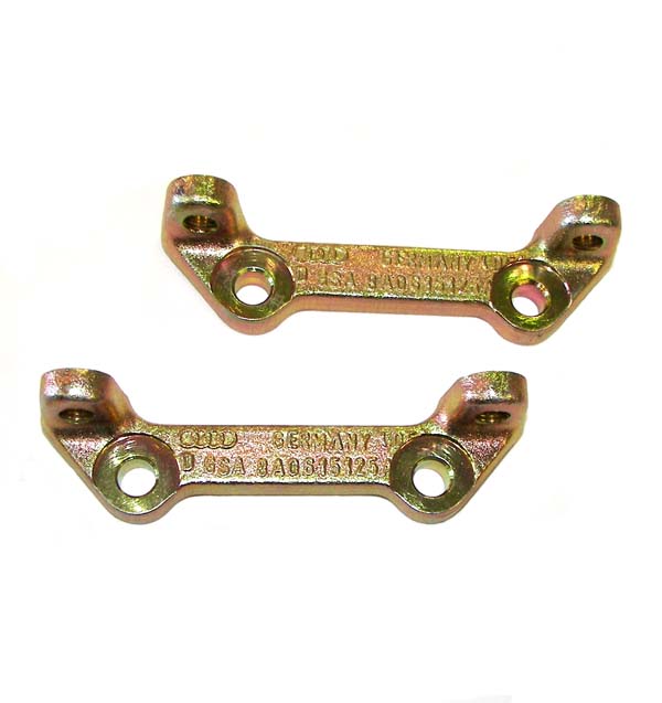

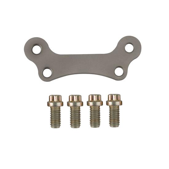

    So I've been doing more research...trying to decide best options for keeping stock wheels for those who want better stopping power w/o upgrading wheel size.
    Stock Setup 1 pot caliper with 254mm Rotor (10")
    Option 1 may be able to use stock G2 prius wheels 15"-16"
    2005 Toyota Tundra 13WL 231 mm Caliper (4 pot) with Subaru Legacy GT 316mm rotor (12.44") - Did this upgrade with my 4runner. Awesome stopping power.
    Requires special caliper bracket fairly easy to fabricate with Standard mounting. Example below:
    or
    Option 2 may require 17" wheel but not definite
    2006 Lexus IS350 Monoblock Aluminum Caliper \ 2007 LS460 caliper (4 pot) with VW R32 334mm Rotor (13.1")
    Option 3 may be able to use stock G2 prius wheels 15"-16"
    2005 Lexus LS430 UCF30 Caliper 268mm (4 pot) with Subaru Legacy GT 316mm rotor (12.44") Requires special caliper bracket harder to fabricate. Example below.
    or
    or
    as a few examples...
