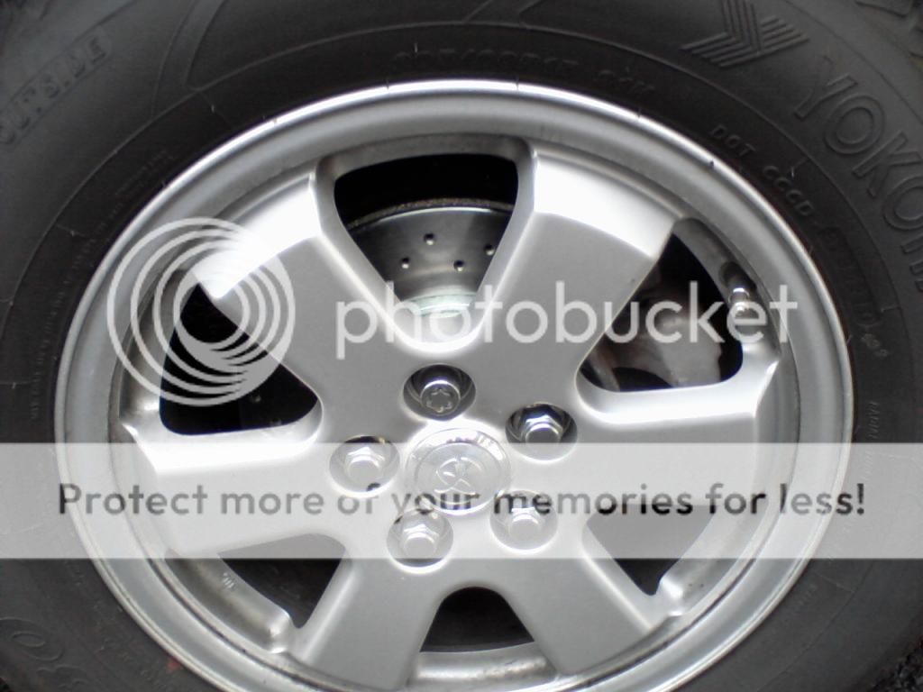

  20. 69shovlhed
    69shovlhed Surly tree hugger
    May 13, 2012
    2,170
    751
    Delaware
    so, rather than mess w/ toyota's brake design, i bought these drilled zinc plated rotors from ebay. they came w/ centric pads, which i think suck, but you could buy just the rotors. they look cool, work fine, and the zinc will keep em shiny for a while.
