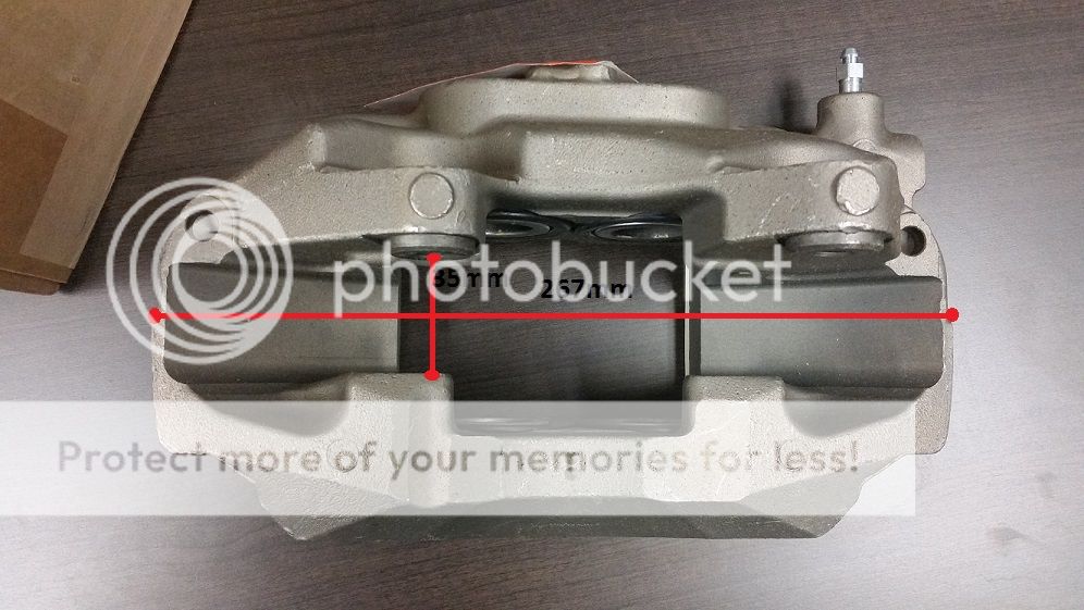

    Parts are starting to roll in.
    Left Rotor
    Rotor Dimensions
    Diameter: 345mm
    Height: 49.8mm
    Thickness: 29.9mm
    Left Caliper
    This stuff is MASSIVE...
    There were cheaper rotors and calipers I could've ordered...but I thought I'd get pretty good quality if I am gonna do this anyway.
    Currently ordered the following parts:
    Stoptech Power Slot Brake Rotor 126.33094SL
    Stoptech Power Slot Brake Rotor 126.33093SR
    Cardone Industries 19-3337 Front Left Rebuilt Caliper With Hardware
    Cardone Industries 19-3336 Front Right Rebuilt Caliper With Hardware
    Bendix D1118 Front Ceramic Brake Pads
    sfv41901 and Daves09prius like this.

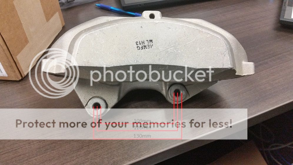

    Oh man... ran into a unforeseen issue. but first...some pictures..
    Which brings me to the problem - the rotors for the VW R32 V6 won't work as they do not have the correct spacing and won't allow the caliper to fit on the rotor with the wheel.
    I will have to source another rotor that will allow for the correct placement of the rotor which pushes the caliper further away from the wheel.
    Probably will do a IS350 rotor and have the bolt pattern redrilled from 5x114.3 to 5x100. Also thinking about doing the IS350 Stoptech blanks instead of doing drilled or slotted. So much research show that solid rotors will assist with the pads and rotors working in conjunction together with the best longevity. Unless cast holes are used, drilled rotors tend to crack after heavy use. Slotted assist for better braking during use in AutoXing but shorten the life of the pads. Solid Rotors will prove in this situation to last the longest all around - just won't look as 'Cool' - lol
    I think the bracket should be fairly easy to fab up once i have the correct placement of the Rotor. I will probably either remove the dust shield or trim it to fit the placement of the IS350 caliper as well.
    Disappointing yet still fun at the same time.

    you might consider a vw rear rotor. it would still be way bigger than oem, but will have backspacing because of the e-brake shoes. you'd probably need a smaller caliper though. if it was me I'd want some powder coated brembos...
    also, since the car uses regen most of the time I wouldn't be real worried about longevity. the dinky stock brakes last so long the rotors rust out before the pads need to be changed. I wish someone would make stainless car rotors. they squeal easier than iron but they sure look good.

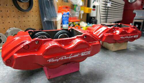

    I'll definitely look into it as an alternative. Currently ordered Stoptech blank IS350 rotors and will have them redrilled to our 5x100 bolt pattern
    Will end up having the calipers look like what I did on my 4Runner using Tundra Calipers.
    A 'TRD red' with a high temp white vinyl logo clearcoated on.

    Primed grey then a close fit to a 'TRD red' - I think this color with some black vinyl letters will fit in with my car nicely..
    Still waiting on the hi-temp vinyl TRD letters before I clear coat these.
