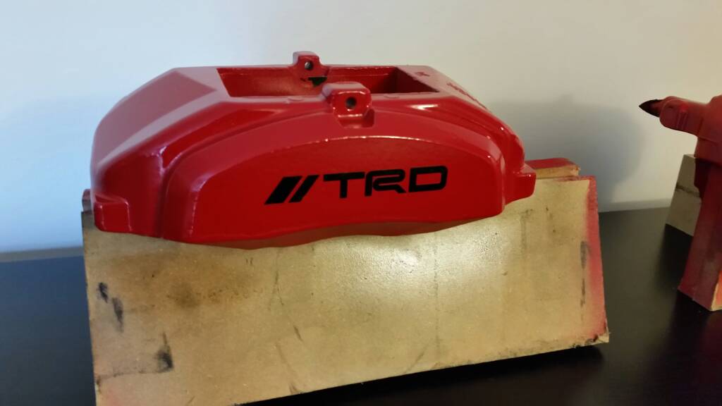

    Got the calipers coated and cleared after the decals came in.
    Waiting on the new rotors to be re-drilled to match the 5x100 bolt pattern then i can start matching up and fabing the brackets for the caliper. Slowly making progress..

    Unfortunately... I'm selling the IS350 calipers, the orientation of the mounting points on the caliper dont allow for proper alignment of the pads on the rotor. Sux, they looked so good. Even cleared my extra 17" wheels... barely.
    The LS430 caliper has a different configuration and should allow for proper fitment. Been working on a few other things but my wife reminded me that i need to sell these before i go out and buy more calipers... so ive been procrastinating.. lol

    Here is a photo of someone else doing a mockup on a different forum.
    Should allow for a better fitment.
