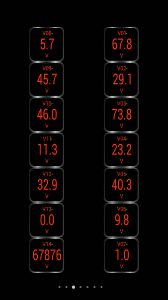

    This is what I get on the battery block voltage v01 - v14. Can anyone firgure out what im doing wrong? I have everything set right except for the header. Header is suppose to be 7.00E+02 but it gives you an error when you test it so I tried auto. I also have to manually enter the custom pids. It wont let me search for the downloaded files on my phone since I cannot locat .torque/extendedpids folder.

    No it's a hex number 7E2, not a scientific notation 7.00E+02. Try pass it in as plain text "7E2". Good luck!

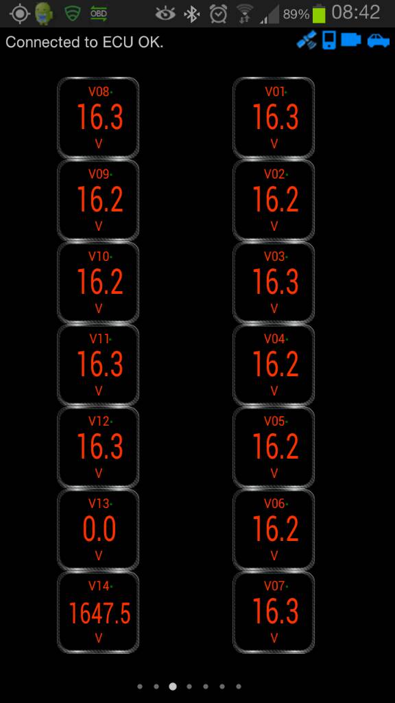

    Entered the new header and this is what I got.

    I havent done that much research but theres 28 modules connected in series. At 7.2v a piece I should show each battery block show 14.4v?

    For some reason my browser can't show images now, but yes each block should be around 14 ~ 19 V depending on the SOC and charging/discharging current (assuming gen 3 Prius battery is similar to gen 2).

    Im currently showing 16 to 17 volts

    Funny the browser shows the pictures fine now. 16 ~ 17 V is OK. Do you still get 0 for V13 and 1600 for V14?

    Nope. All the same now. Between 16 and 17
