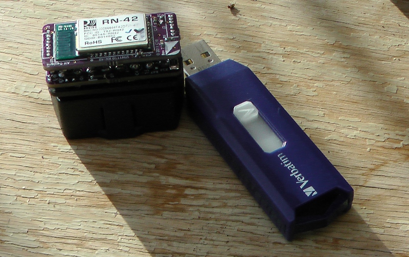

    Hello Paja,
    I got the adapter from AH fully operational.
    It has no casing, it is really small , see picture...
    I tested the same blue thing in your link.
    It was really slow and not stable, real garbage...

    Paja,
    I'm the one who designed the module you're referring to. Yes, all of the modules at my site (I'd post the link here, but I'm not allowed to yet, so you'll have to refer to Frenchie's post above) do not have a case, but they are all the same physical size, if that helps you any. I'm in the process of trying to have an enclosure made for the unit, but I don't have a lot of money to spend on tooling and all that for my very low volumes of this thing. It's essentially a hobby project, not my full time job =). If there was a need for say I do not know, 50-100 of these modules, that would provide plenty of money to have an enclosure made.
    That being said, the module that Frenchie has is very low power, and it doesn't produce a lot of heat. If you wanted to, you could encase the entire thing w/ epoxy or something like that. I haven't tried that, so I can't say that it'd be the best thing in the world to do, but I don't see any issues off hand.
    My Bluetooth OBDII module does utilize the STN1110's sleep functions in 2 ways. The 1st is the STN1110 will go to sleep if there's a lack of UART activity (I think I have the timer set to 10 minutes or something like that). The 2nd sleep function is an external line from the Bluetooth module that puts the STN1110 to sleep immediately when there isn't any Bluetooth connection. The RN-42 Bluetooth module also goes into low-power mode when it's not connected to anything via Bluetooth. Using all of these power save modes along w/ an efficient power supply in the unit allows you to leave this module plugged into your car w/o having to worry about it draining your battery.
    I do not know of any other STN1110 based modules besides the ones I've designed and the ones at Scantool. Most cheapo modules you see at the chinese sites are using ripped-off ELM327 chips or poorly designed clones. Most all of these cheapo chinese pieces of crap have some sort of compatibility issues with vehicles they're used in or the device they pair via Bluetooth to.
    Let me know if you have other questions about my OBDII Bluetooth adapter!
