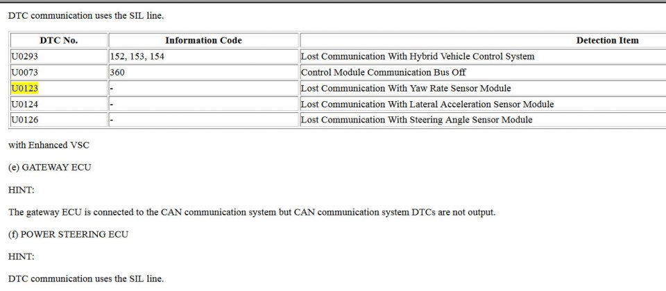

    Here's some DTC information.

    1. One possibility is that your scanner is generating bogus DTC since you don't see any of the skid control ECU warning lights on [such as ABS, VSC, or ((!))].
    2. If the codes are valid, then the skid control ECU has lost communication with various sensors as well as the HV ECU.
    3. I agree with the suggestion that you should clear the DTC and see what happens. If you don't see any warning lights appear then I would not worry about this.
