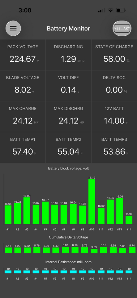

    I have an 08 with about 270,000 miles. I replaced the original battery with a Nexcell lithium a year or two ago and let my son use it while away to college. It came back home and threw a code for the inverter pump. I replaced that.
    The next issue was Dr Prius showing a low module. Nexcell sent me 1 new one under warranty because there weren't many miles on the set. Nexcell was coming out with a new version and the lithium version was obsolete. Nexcell included a balancing harness which I used. I never got it completely back together and running for anything but short trips.
    Next it threw a code for the battery controller circuit. I forgot what code is (P3000?) but there are 3 variations of the code and youtube university says it's most likely corrosion in one of the connectors.
    I got side tracked and the car has sat for 6-8 months with the safety plug out, the wiring harness that connects to the copper busses off and the 12v battery disconnected.

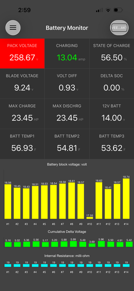

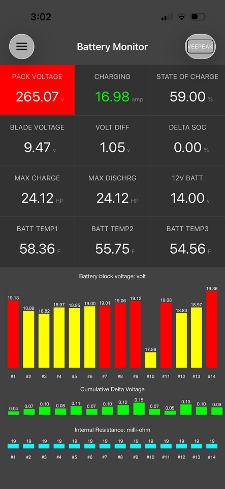

    I now want to get it going but it threw a code P0321 which is for module 11. Attached are some Dr Prius screenshots taken close together. What is a methodical way to go about straightening this out?

    There is a reason why the lithium version is obsolete. It had problems and was not reliable.
    Your best path to resolve the problem is to replace the lithium version with a standard Toyota NiMH hybrid battery. Cheapest option is a refurbished hybrid battery. The most reliable option is a new Toyota OEM hybrid battery from a dealership, but you need an OEM core to get your $1350 core charge back (so you are screwed unless you still have the original battery). Another option is to buy the hybrid battery from a junk yard in your area or from eBay.
    You are one of many NexPower lithium battery customers who got screwed. Live and learn from the experience. FYI, the first version of the NexPower Sodium-Ion battery that replaced the lithium version also had problems and is obsolete.

    It's not looking good based on the Dr Prius screenshots. 13 of the 14 battery blocks are bad.

    agreed, i just meant the shots were a good start for analyzing and diagnosing the problem

    @Brian1954, how do you know that the 13 blocks are bad? Is it possible that they only need charging and refurbishing?
    I think the only thing that's affected by not having the cover on is the fan isn't blowing where it should be. Is there anything else in the area that could be having an effect? The screenshots were taken within 3 minutes of each other. I can replumb the fan and let the car run if that would give any more useful information.
