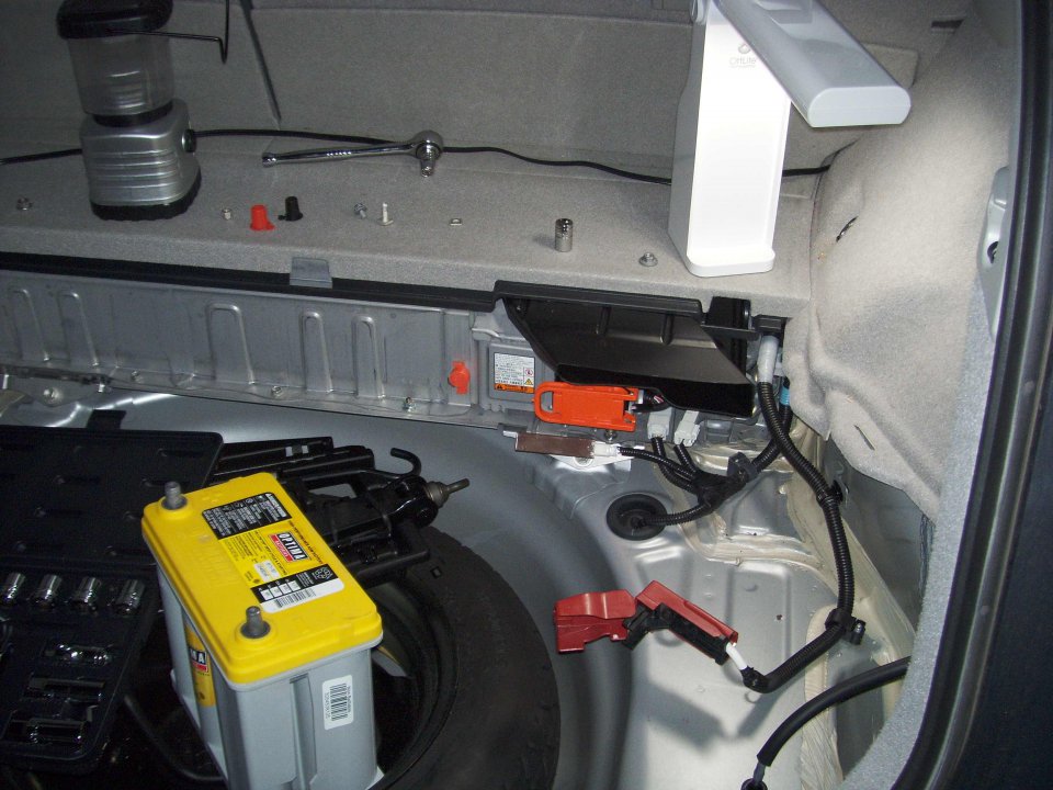

    Are you dragging the parking brake? Engage & disengage the brake just to be sure. Ask them to check to see if the wheels spin freely while the car's on the lift.
    If you have the NAV or AT package you can put the map display in Maintenance Mode to get the voltage figures.
    The 12v battery is in the right rear wheel well. Remove the mat, rear deck floor, storage tray, and right side cover (a roughly triangular shaped piece). Everything just fits in place with tabs. You'll see the spare bolted to the car, the rear of the traction battery below the seats and the 12v to the right. As mentioned, use a volt meter to measure the voltage.
    In the photo the empty space to the right of the Optima battery is where you will find the OEM battery. Just based on the age I believe you are due for a new battery but there is no substitute for knowing. I would also get a BatteryMinder to keep the new one charged up. Driving 20000 miles a year isn't enough to keep the battery charged and desulfated.
    You'll need metric sockets (8mm & 10mm?) and will need to get that red contraption off the positive terminal and installed on the new battery. It's a 2 hour job as a worst case.
