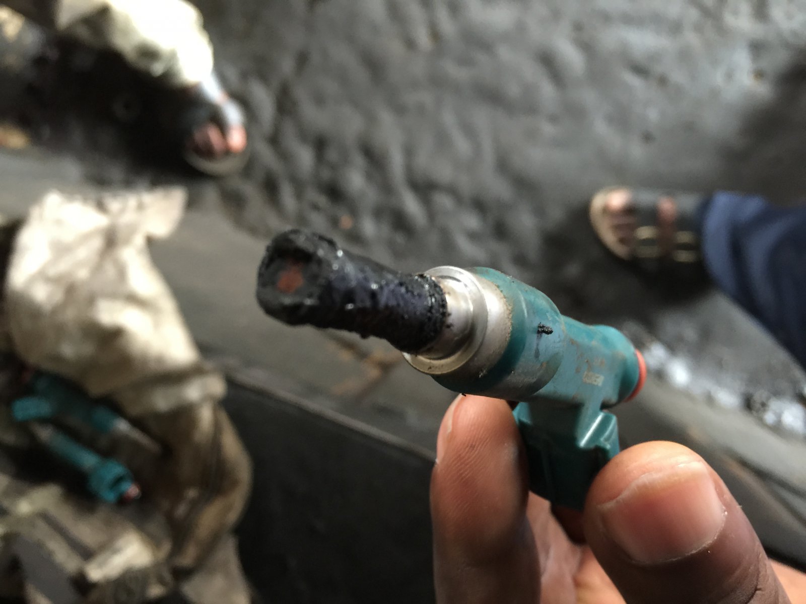

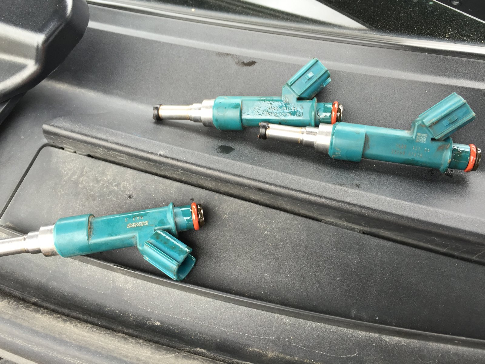

    Those areas you're looking into aren't the cylinders, just the intake ports of the head. They look a bit like mine did this past weekend, maybe a bit more carbony.
    If you look all the way straight in, you can see the shiny-looking 'septum' between the two intake valves and, on either side of it, the stems of the two valves themselves. Looking down the stems, you can make out the valves. If they were open and you could get your eyeballs in there and look down, then you'd be looking in the cylinder. :)
    What's like I saw this weekend is you've got all this carbon in the ports at the entrance and in about as far as the fuel injector, and after that the aluminum is shiny and clean, and the valves too, everything beyond where the fuel gets squirted in. That's the detergent in the fuel blend doing its job.
    Now, the thing everybody hates about a carboned-up intake is that that carbon layer is porous, kind of a hard sponge, and in the old days the fuel-air mix coming in from the carburetor could have the fuel soaked right out of it by the carbon sponge, and give you fits with cold starting. That would still be a problem here, if the carbon were in that part after the injector, or on the valves.
    But if it's just in the part of the port upstream of the injector, it isn't going to cause you that problem; there's no fuel in that air yet to soak out. Sure it might impede the airflow some minuscule amount, and you might prefer looking at it cleaned, but I wouldn't make a big production of it.
    (Looking again at your photo, I can't be sure if there's also carbon back there in the supposed-to-be-clean area around and behind the valves, or if that's just the lighting. Mine was all clean and shiny back there. If you've got carbon back in that area, then yeah, you probably want it out.)
    If you look up in that port you can see part of the neck of the fuel injector where it pokes through. What you do not want to see is this:
    I had that image from PriusChat seared into my eyeballs so I made sure to look up in my own ports, but for whatever reason my injectors did not look like that at all. They looked almost like these:
    clean shiny metal necks, just showing the contrasting black plastic bit on the end.
    If that's how yours look, they're probably good.
