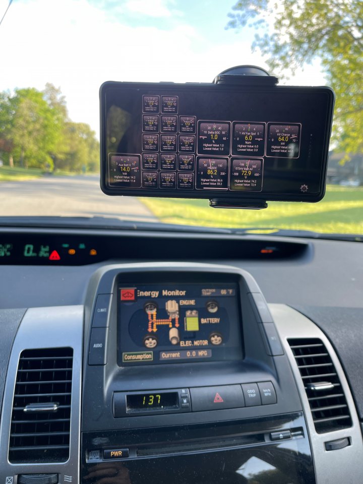

    Hello all,
    I have a 2007 Prius, 124K miles, great car, never had any troubles until someone chopped off my catalytic converter - which I had the dealer fix. Then, all of a sudden, red triangle of death. So I grabbed an android phone, an OBDLink Mx+ and torque pro. I had a leaky prius, 12v battery in at least 6 inches of water, and the car sat idle for 10 days at the dealer while they waited for a cat shield.
    Took the car to the dealer's carwash and red triangle of death. Drove it back to the service area, they pulled a P0a80. They cleared it, road tested it, and they got another RToD when driving near the car wash. They had no clue, said I had no codes after the cat replacement, clearly were concerned about a battery replacement but I don't believe in coincidences. They had no idea of the Gen 2 water issues.
    Anyway, fixed the leaks, aux battery pulls 12.2v, no water after a thunderstorm and a car wash. However, I keep getting RToD's, DTC p0A80 and sometimes p3022. The odd thing is that Torque Pro shows the cells look pretty good (2 weak ones), but the MFD jumps all over the place. RToD when MFD shows battery full. Will add some screen shots.

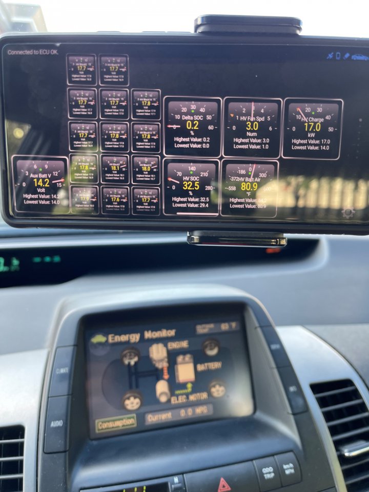

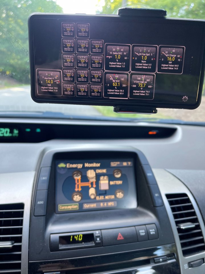

    This pic is coming home, get RToD, pulled over and took the pics below, put it in drive, no power and absolutely no MFD indicator between the elec motor and battery. Stop and start car, connection resumes as normal
    This is after clearing codes.
    HV SOC is all over the place -
    At a stop, no ICE, battery showed charging to full green with no power input, dead stop.
    This one RToD, green battery.
    RToD while driving, green battery on MFD, cells at 17+.
    Below, Battery at one bar, calls all at 17+
    So I'm a bit confused. The MFD seems not to agree with the raw data, or I'm missing something so obvious that y'all going to laugh at me.
    A couple of the cells are a bit weak, but the MFD is acting like I need an exorcist or something.
    Any ideas or guidepost y'all can share? This computer nerd can't figure out how the inputs can lead to the outputs in the MFD. Also, looks like cells are OK, but the HV SOC and HV charge vs. the cell charges don't make a lot of sense either.

    classic symptoms of a bad hybrid battery, not unexpected after 16 years.
    you can try opening it up and cleaning any corrosion, but those old cells aren't long for this world

    Using Torque pro, I can see that two of the modules (7 and 12), when discharging, are always low at about 15.0 and 14.9 when the rest of the modules are at 16.3-16.5. In terms of a significant difference, where does the point where rebalancing might work taper off? Would a volt and a half difference for the "bad" modules be something that might reasonably be worth the expense of a rebalancer or is that a big enough difference where a module might be better replaced (since there are only 2). They do charge up to full charge, but tend to drop faster.
    Just trying to avoid the cost of guessing wrong. With the variance in data from Torque to the MFD, the options of rebalancing, or HV ECU replacement or modules or more tends to add up quite a bit. If I had to go full replacement, I'd probably go lithium from what I can see. Toyota in my area will sell a replacement for $1650 with core turned in, newpriusbatteries wants $1888 and projectlithium wants 2120, all the warranties are about the same, so it's a balancing act with Prolong wanting $719 for the full conditioner.

    Don't be confused. When the car's HV control ECU makes the judgment of whether to announce a P0A80, it is looking at more data than just the voltage reading snapshots you are looking at. It's doing computations on things like the relationship between the voltage and the current, and the behavior of both over time. You can't really second-guess it by just looking at a screenful of voltage readings.
    It's been saying P0A80, and you've been saying "hmm, based on my Torque Pro screenshots I don't think you really mean that", and it's been saying "no, really I do."

    More to the point, when the hybrid back is only sending or receiving a small amount of amps the voltage in the Torque app look fine, but when you're sending a super big charge to the pack by braking hard on the freeway, or draining the pack by accelerating hard the weaker cells can't keep up and the "voltage difference" between blocks gets up over 1 volt and you get a red triangle.
    In general Torque app is garbage and the PIDs you're using are outdated... Try Dr. Prius app instead... It gives real time graphical data of all blocks in an exaggerated way, as well as a "voltage difference" number in real time, as in much faster refresh rates than Torque app.

    The mfd is only showing a graphical representation of total voltage. Almost any battery can show appropriate voltage after it had a charging voltage applied to it. The real test is how long can it hold the voltage under load. A bad battery discharges fast. The overall amp hour capacity of a worn battery is small.
    Often a car with a weak hv battery can't stay in ev mode using ac at a stop light. The car can feel abnormally underpowered with a soc of 32.5% as in the last pic. Once it charges up again, it will feel normal but not for long.
    Regardless of what the reconditioning guys say, a battery is a limited lifetime device. You have many batteries combined in series, so some eek out a little more time by replacing the weakest modules. Often again and again. New cells are the next best thing to a new engine. Sometimes better.
