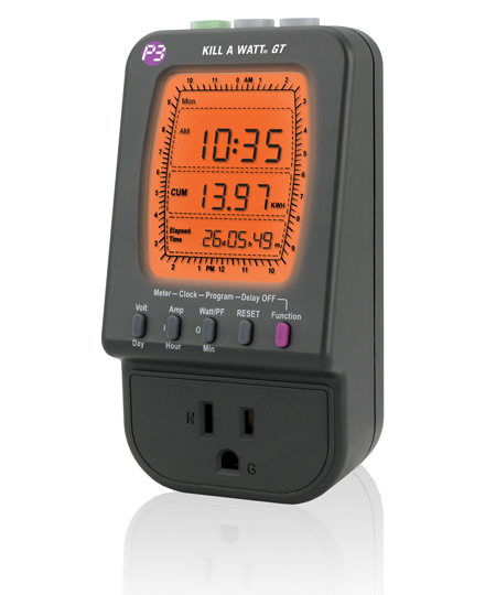

    If OP would use one of these and his odometer the problem would solve itself ;) ;)
    Only 18-40$ to have your answer...

    In case anyone is interested, here's the meter I'm using to monitor actual energy used to charge. Haven't had it for very long (Xmas present to myself) but so far I really like it.
    DROK Digital AC Multimeter Voltmeter Ammeter 80-300V 0-100A Watt Power Energy Meter
