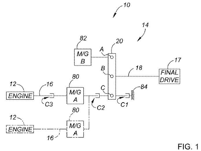

    Winston, the latest I read was that the control logic allows the ICE to come on at speeds as low as 35 mph in CS mode. Makes sense to me from an engineering standpoint.
    So, do I understand correctly that a G/M *always* is in between the ICE and the PSD ? If so I have to say that the grumblings about the design having a direct mechanical connection are mis-informed. It would just mean that all the power flow does not go through the battery and the main traction motor.
    Addendum: is this right ? (the connections to the PSD should not be read to infer which gear is linked to which component)
    Code:
    ICE ------ // ------ G ------ // ------ M --//-- PSD --- Wheels                 |
                                  -------- Inverter - Battery ------ Traction_Motor |

    Perhaps you missed this thread. It has this picture of the layout and more.

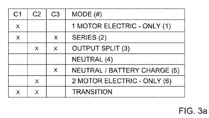

    That's also possible but technical reason was given by GM. It was done for performance reasons in CS mode.
    In EV mode, going above 70 mph, MG2 (MGb) torque drop and it become inefficient. MG1 (MGa) is brought into action to assist (mode1 -> mode6). Spinning MG1 also drops MG2 rpm due to how they are hooked up to the planetary gearset. This is all great and clever in EV mode.
    However, in the CS mode with the gas engine running and connected to the MG1 (generator), all three ICE/MG1/MG2 are forced to turn the wheels (mode3).
    GM can choose mode2 instead of mode3 so the ICE does not power the wheels but the performance above 70 mph would suffer without the assist from MG1 and ICE. It was an either or scenario.
