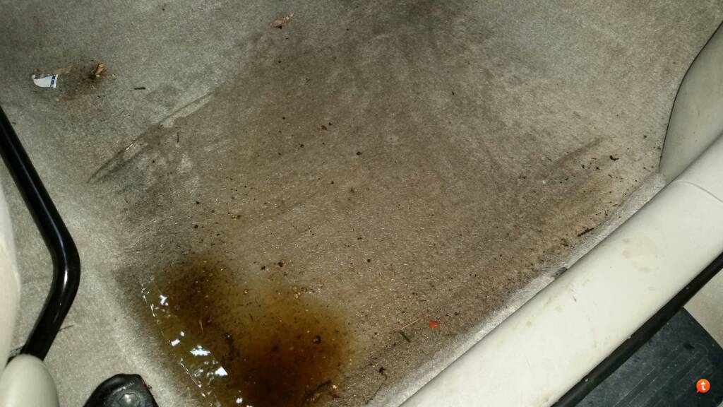

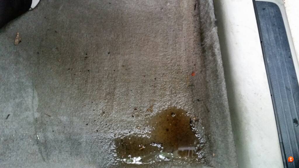

    Went into work at 8:30. It was pouring rain. No leak. Haven't had an issue with leaking. Get off work at 5:30 and open my car door to a puddle on the passenger side. In Kansas, we get a lot of rain during the spring/summer. This is the first time anything remotely close to this has happened.
    The only issue we've ever had has been with, what the dealership calls, condensation from the AC dripping within the car. Only happens on a hot day with the AC on full blast.
    This puddle doesn't seem to be from condensation. Arrive at work, no water. Leave work, water. Doesn't help that it basically cleaned our dirty floor mats.
    I've done a little bit of searching, but nothing directly pertaining to something like this. I'm not overly technical, so I can't exactly tear apart the car. I'm mostly just wanting any sort of guidance. We do have a warranty through the dealer but, naturally, they aren't very helpful with this.
    It's a 2007 Prius. Purchased used from the dealership in November 2012. 102k miles on it.
    Any input is greatly appreciated. Thanks, in advance.

    Maybe just a bad seal on the Windshield. Looks pretty dirty though. Spray it down real good with a hose and see if it'll leak again.

    Well that sounds like a leak to me.
    What did the dealer DO about it ?
    It usually means that the AC drain hose is blocked or pulled loose at the top.
    Don't completely dismiss that as the cause this time too.
    You won't notice the leak at first because it will be under the carpet and only becomes evident as it gets deeper and soaks through.
    More water runs down from the AC when you stop.

    It had been raining non stop Sunday-Tuesday. Didn't happen until Tuesday. Why would it not leak two days prior?

    Dealer basically said we were crazy and imagining a leak. Didn't flush or even try to fix anything.
    AC had not been running for three days. It's been cold out.

    Also, the water is dirty because it ran down our old dirty rubber mats.

    IF.....it was raining, it might have been damp enough for it to run for de-humidification, whether you had it turned on or not.
    Guess it's also possible that it is antifreeze.
    Maybe you should take it to the dealer NOW......with the water still pooled up on the carpet.

    Check the trunk.
    If there's any water under the tire you probably have a leak caused by a body crack or cracks in the hatch corners Many posts about that.
    Easy to search.
    Open the hatch and right where the upper corners meet in the hatch well right off the hinges is where there's alot of body flex. Thats where the roof and the side pillars are welded together and puttied. You may see a crack coming from under the black plastic strip that runs the length of the roof where it ends at the hatch corners. Pop that black plastic strip up and look under there.
    If no body cracks there you have an ac leak from the drip hose. And thats because the ac system has not been maintained.
    No posts about windshield leak except those who have been in a front end accident and have had the windshield replaced and performed poorly.

    Turned the AC on after work today and got a little leakage. Will see what I can do this weekend

    This is a fairly common problem as cars get older.
    Over the years, several home remedies have been tried.
    This from reports from others:
    Do NOT try blowing back UP the drain hose to un-clog it. All the crud, part of which probably is MOLD, will be blown all over the AC coil and inside the duct work.......making one HELL of a mess; sometimes a stinky one.
    If the drain hose is plugged up, running a soft wire up the hose (like copper), followed by a good suck with a shop vac. sometimes has good results......sometimes.
    A dis-assembly of the duct work and a thorough cleaning is the only really good fix......but that is complicated and thus expensive on most cars.
