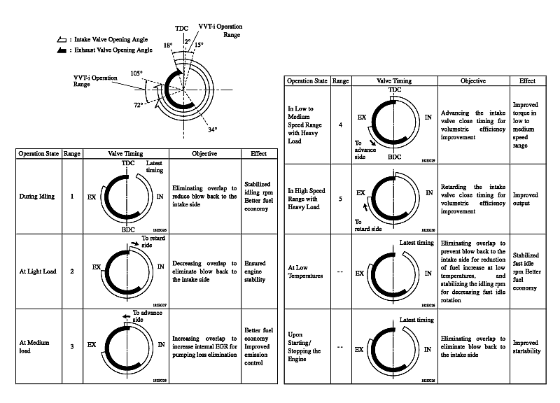

    This is the Gen 2 Prius, you can see how much the intake timing can be altered. It would take a lot more range to make it to the Otto cycle. (Exhaust timing appears fixed)

    And this is exactly the behavior we want to eliminate... the duration of the intake cam past BDC. Let's see that 13.0:1 compression! (and hope the pistons & con rods can handle it...)

    so who's the brave one that will have their intake cam ground down? looks like about 25 deg should be taken off the back side of the lobes.

    ...Sorry, never modified stock cams. What will this do based off that diagram?
  18. 69shovlhed
    69shovlhed Surly tree hugger
    May 13, 2012
    2,170
    752
    Delaware
    by grinding 25 deg off the closing side of the lobe, you'll have 50 deg less duration of the intake valve hanging open during the compression stroke. that would make a tremendous increase in dynamic compression. static compression is 13-1, but since the atkinson cycle ice lets the intake valve stay open well into the compression stroke, it ends up being closer to 8-1, and acts like a smaller displacement engine. so if we can close that intake valve early in the compression stroke, we're gonna get alot more power, but probably need higher octane fuel to avoid pinging.
