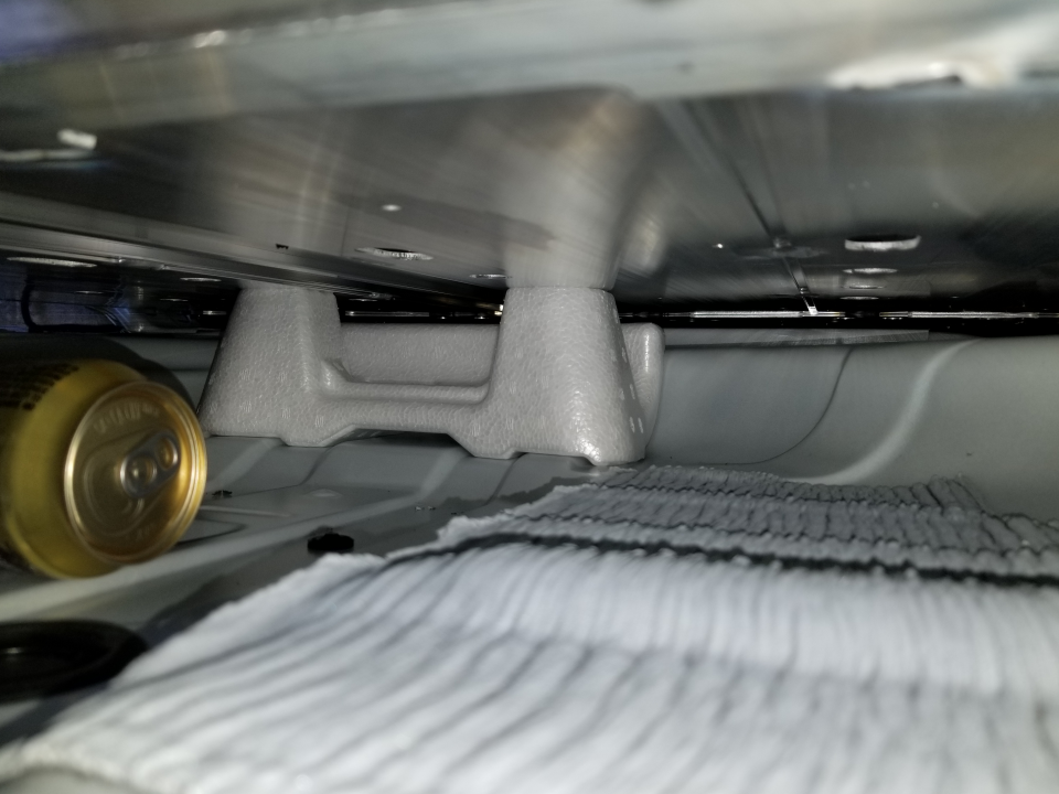

    you need to find pics of the 3" space under the battery.
    keep in mind, toyota sent prime design to the u.s dealers with an even smaller battery, and the dealers sent it back with a note: will not sell well in the usa
    that's when the battery showed up above decks

    you need this space for the air cooling ;-)

    If you have them, show them.

    i don't have them, they are in another thread here, by @Lee Jay iirc

    i doubt it, but the sides are tapered which means the battery would have to be narrower to be lower

    Here's the under battery space. I found the missing 4" (vertical) in the trunk. It is below the battery. | PriusChat
    It is an ICE car platform, and leaves the spare tire well empty in the Prime.
    The Ioniq PHEV loses just half the cargo space from the hybrid that the Prime does.
    I think they did a bad job with those constraints, but they were probably also under one for time with having to increase the battery size after feedback from markets outside Japan.
    And crumple zones.
    Same place Ford is putting their battery cooling in the new Escape and Explorer hybrids.
    Depending on trim the Escape hybrid premium is $800 to $1200. The same as to $400 more as for the Rav4 hybrid.
    No, they should have looked at the Volt and Energis, cars that arrived 4 or 7 years before, and the public response to them. Or they could have just considered markets outside Japan during the design stage. North America is a bigger plug in market than Japan, but the Prime likely had a battery the size of the one in the PiP at first since that fits better with Japan's infrastructure.

    That is quite a bit of space under the battery! Sounds to me that they have quite a bit of room to work with to lower the battery while maintaining the same capacity.
