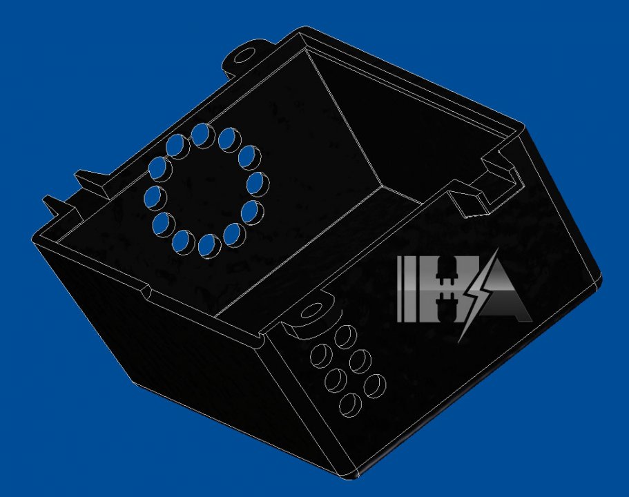

    I was actually working with my Mechanical Engineer today. We are working on a new fixture to improve the Prius fan control board enclosure holes. We currently hand drill each one from a sheet metal template. He is building a special fixture from hardened tool steel to more precisely locate and align the fan inlet and exhaust ports. It's a minor item really, but we want our to continue to improve the product whenever possible. Here is a peek at the CAD layout of the fan enclosure, which is the first step to building the tool:
