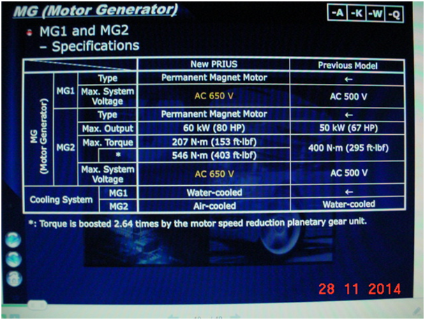

    Patrick said: After reading about the MG1 and MG2 info. I remember reading that both are in the same area and you only need to watch one of the two for temps. So I watch MG1. MG1 temp never went over 155f.
    I would advise you to monitor MG2 temperatures for a while, the reason being MG1 is water-cooled and MG2 is not.
    MG2 is air-cooled.
    #5 olieman, Nov 28, 2014

  7. olieman
    olieman Junior Member
    Oct 24, 2014
    Netherlands
    @szgabor:
    No, I was not smoking pot..;)
    sorry,
    I could not load "the link" to the Japanese site, I am pretty new here, not enough credit yet.
    below on the picture; you can see the air-cooled note next to MG2
    You know, the Prius c /Toyota Yaris Hybrid, P510 Transmission has no longer water-cooling at all, just air and circulating transmission oil.
    I have a Yaris Hybrid and realy need to watch MG1 and MG2 temperatures well with the use of a grill block.

  12. szgabor
    szgabor Active Member
    Jul 29, 2009
    994
    175
    Oceanside NY
    sorry but this was posted on the 3rdGen Prius forum so I assumed you are posting about that model ... but if they are in the same oil how much their temp could be different. Surely dynamic temp spikes are possible but those would occur in water cooling scenario as well !!!
    Also if they are NOT water cooled ... how the grill blocking would affect them? Really worth some investigating but I do not think it makes much of a difference. The CVT is not in the direct air flow from the grill in any case.

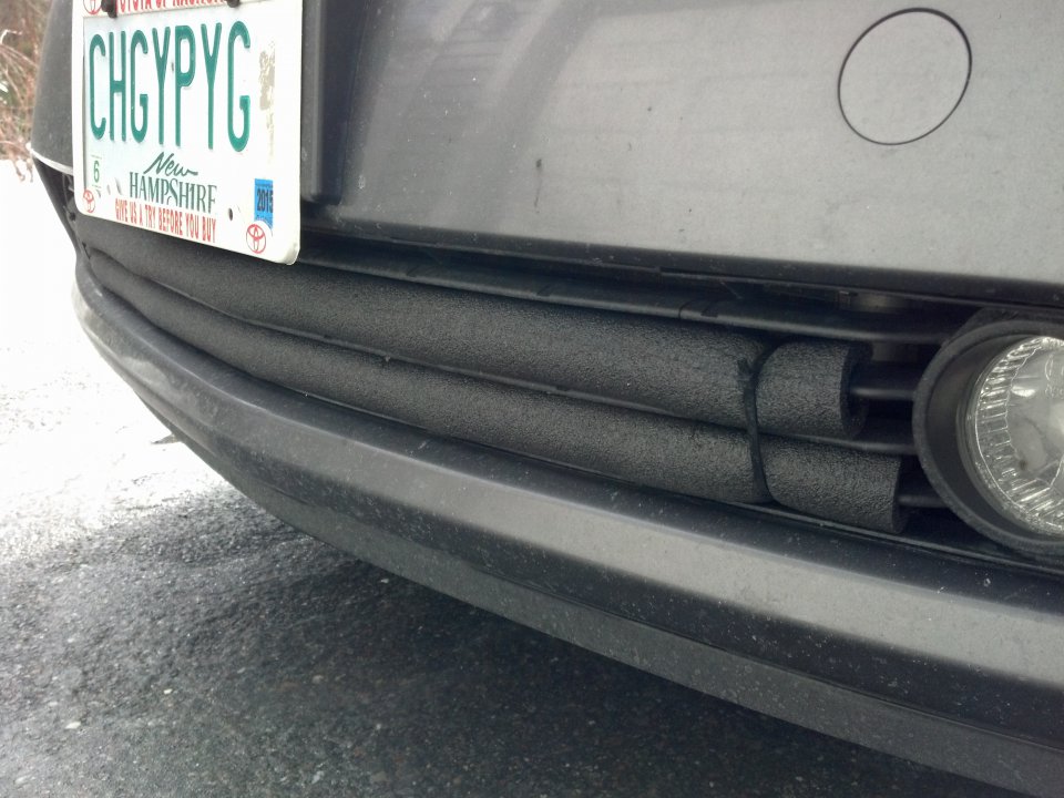

    I've had my 2009 Gen II Prius for just over a year, and I've blocked the lower grill for each of the past two winters. I have a ScanGauge II and so am able to monitor the ICE coolant temp - which is normally around 190ºF, the blocking helps the system get to that temperature quicker, but the highest I've seen the temp is 196ºF. A couple of weeks ago during a particularly cold snap here in the North East, while on a run where the temp was normally ~190º, I noticed it barely got up to 170º, but that's about what I expected. Here's a pic. IMG_20150119_123345_823.jpg (regular ½" pipe-lagging from Home Despot ($4) , and zip-ties at each end) - hope this helps - Wil

  19. WilDavis
    WilDavis Senior Member
    Feb 4, 2014
    2,493
    2,155
    49
    Here's a pic. [​IMG] (regular ½" pipe-lagging from Home Despot ($4) , and zip-ties at each end) (…is there an echo in here? …
    echo in here? …echo in here?…echo in here?…echo in here?) ;)
