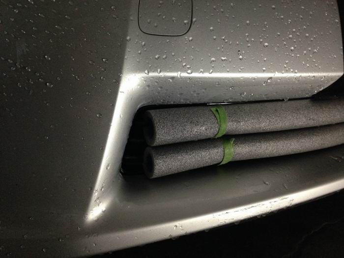

    I used zip ties at first. Very secure, but not convenient for removal or adjustment. Here's the tape I'm using, holds securely, and I've re-used strips for multiple years, still ok:
    Velcro® Plant Tie - Lee Valley Tools
    I use the tubing for 3/4" diameter piping, it has an OD of about 1.5".
    FireFire likes this.

    I see. Thank you for your pic. Will see if I can come up some idea next winter.

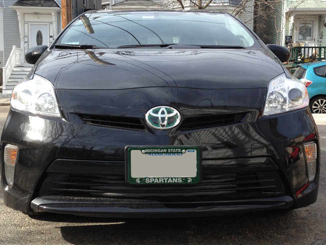

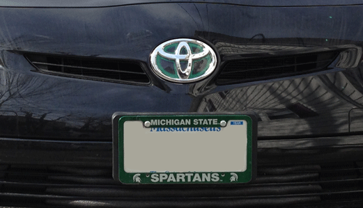

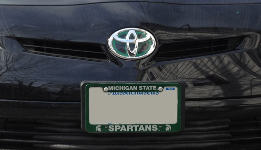

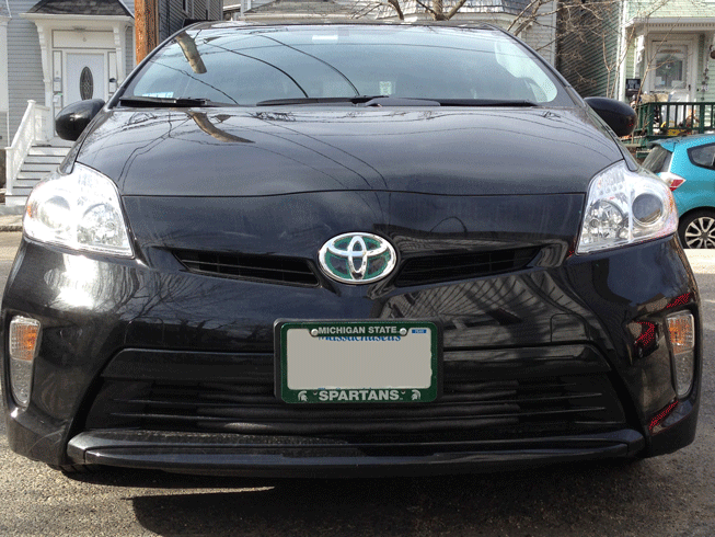

    Hah- you're lucky, it's still 36F here today with some snow/sleet, so I'm keeping the grill blocking for now.
    For future reference, I use the pipe insulation as well, but I actually squeeze them down and fit it between the slats. If you measure correctly where the verticle pieces of plastic stick out and use a marker to mark the spots on the tubes. Then cut half way through the piece (be careful not to full cut through) at those spots. Then you can squeeze the pipe insulation to fit each area, and the cut piece fit around the verticle pieces. You don't have to use any Velcro it stays in place and won't move and I think it looks better. You can pull the piece out when your done (carefully) for use the next year. I've reused the same pieces for 3 years on my Prius v, and my standard Prius this winter. (I'm assuming the Prius c has a similiar grill to the other two)
    I have some pictures from another posting below so you can see what I mean, if your interested in doing his next year.
