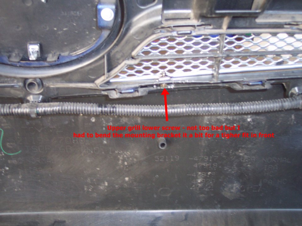

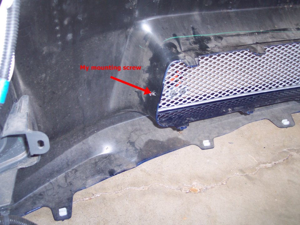

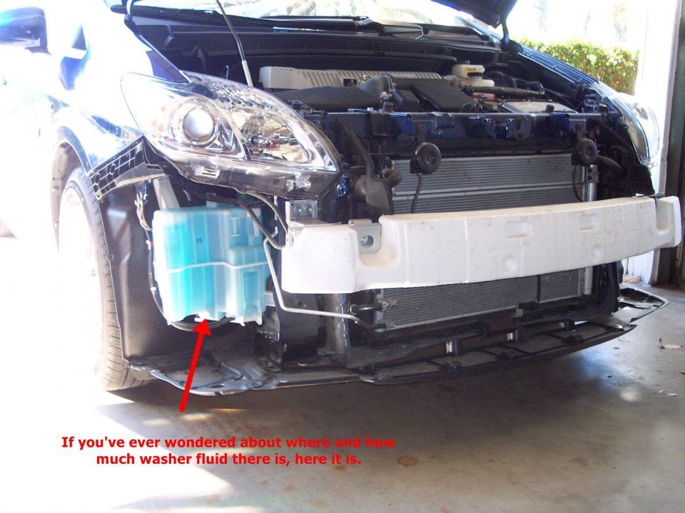

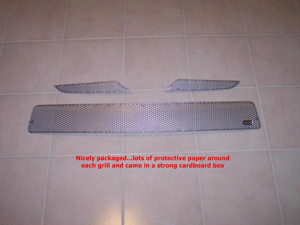

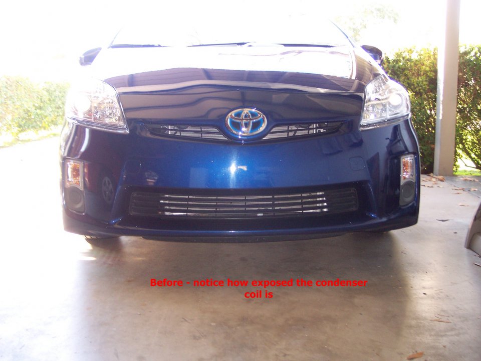

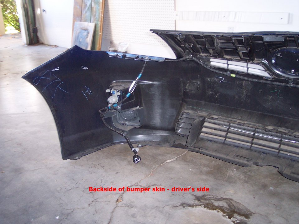

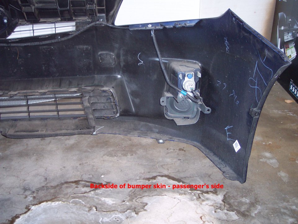

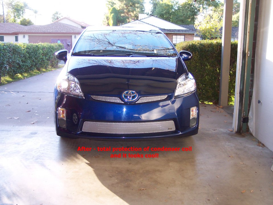

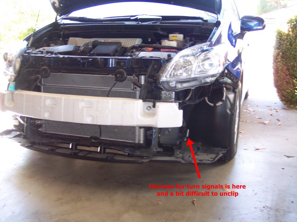

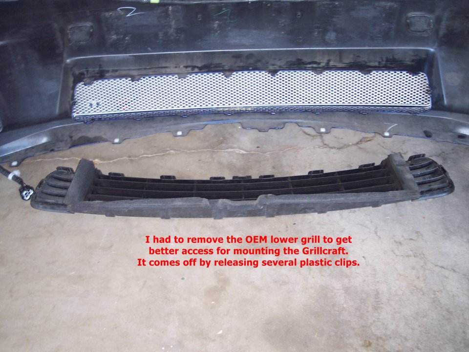

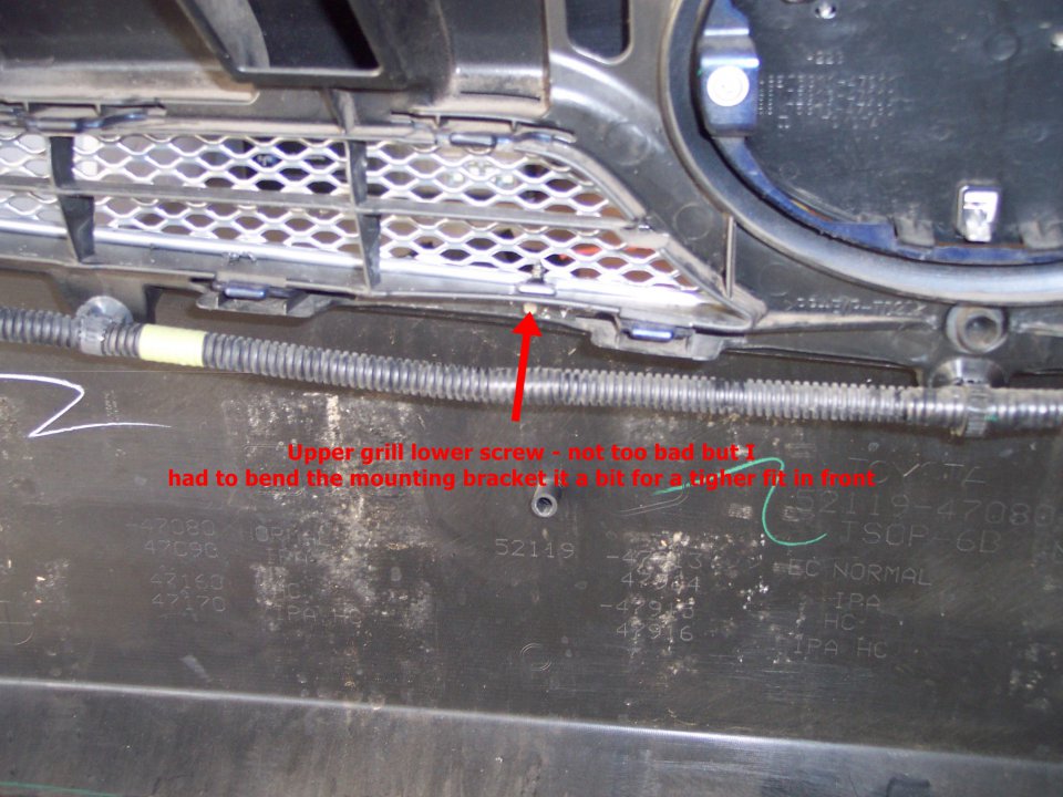

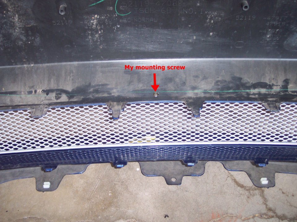

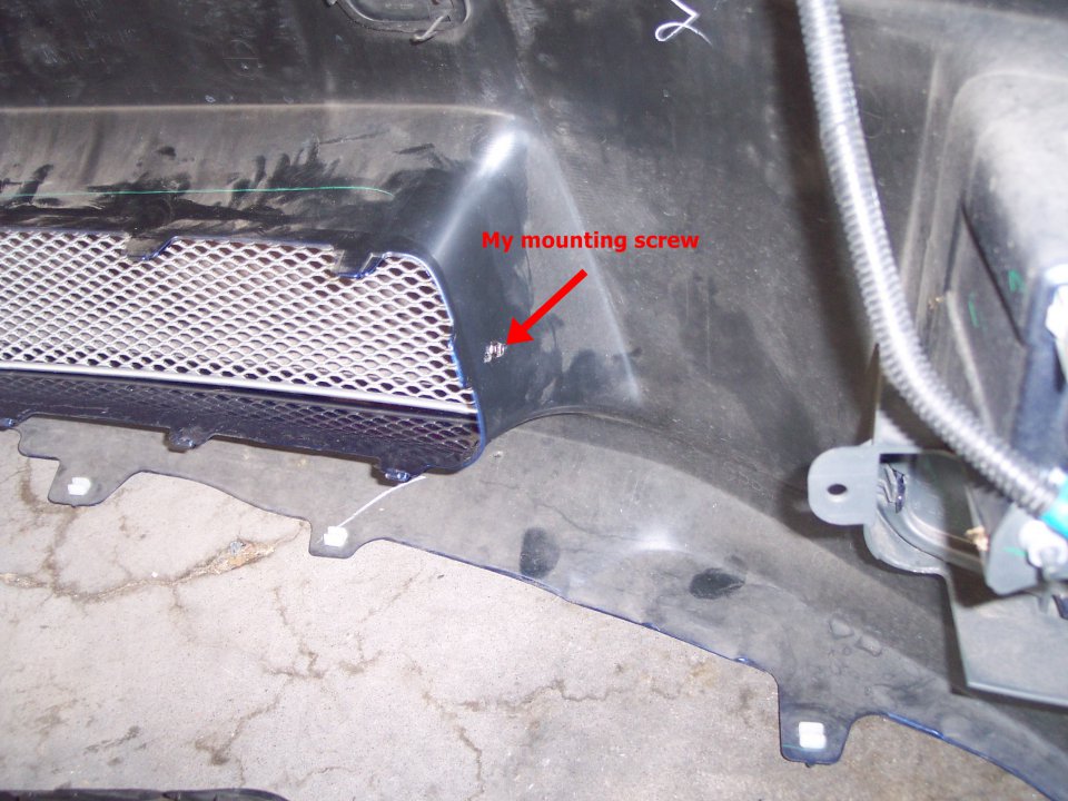

    I got the Grillcraft front grill set as a gift last week and decided to install it yesterday. The set comes with a couple of pages of instructions which clearly show how to remove the front bumper to do this. There is one harness for the turn signals on the driver’s side which was tricky to unclip. I suggest if anyone tries this to have plenty of old soft large soft towels to lie down on the pavement so when the bumper comes off, the front is laying on them so it doesn't get scratched.

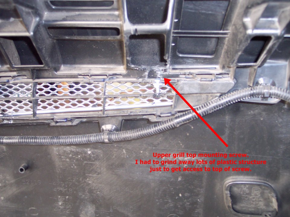

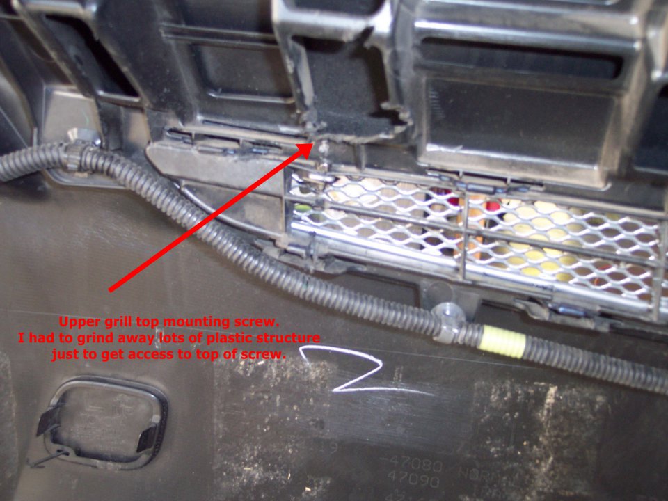

    I would say this is a tricky installation and over-simplified in the instructions. For the lower grill, I had to eventually unclip the OEM black plastic one before I could get the holes right to hold the new one in place. Spacing and centering is not easy for the lower grill. The upper grills were difficult too in that the top mounting holes were nearly impossible to access without first removing some of the plastic inner structure above them with a grinding tool. But I finally got a good fit and think these grills will protect the condenser coil from bugs and stones.
    If you are good with tools and feel comfortable removing the front of the car, I’d rate this on a scale of 1 to 10, an 8 just because of the difficulties in working from the backside of the bumper skin and getting the proper spacing and centering of the pieces. I have some pictures here to show the process:

    To your point though...recently at my dealership I got a good look at a C. Wow, the condenser coil is really exposed on that model.

    phoenixgreg, thanks for the pictures, I have considered doing the same, I like the look. I have my lower grille to replace and the heads up on the wire connection is appreciated. I'll wait for warmer weather to take the front end apart, have my grille block on now.

    You're welcome and to 32kcolors point, the small moniker on the lower grill that says "GrillCraft" is behind an attractive thick polymer and is not too noticeable. If you want a plain look without it, there are two screws behind it so it can be easily removed, if that's you preference. Good luck when you install yours - you will need some kind of small grinding tool (use carefully) to make access for the upper screws on the upper grills.

    greg,
    do you think it is possible to remove the lower grille without removing the bumper?
    I was studing your pics, and it looks like its a basic clip I was thinking something like a putty knife or regular screwdriver between the grille and bumper to release it from the front...
    yes no?

    ok, I got the upper clips undone, but the bottom ones are proving to be stubborn...

    When you say clips, are you referring to the OEM clips in the lower black plastic grill? They will eventually work free, just pry on them in sequence until they release one by one. Replacing it is a snap, literally :) I assume you removed the bumper skin first. This mod has to be done (if you have Grillcraft) with the bumper skin off.

    clips/ tabs, yeah... but no I have not removed the bumper skin. i was hoping to remove the grille without pulling the bumper skin... the top tabs were easy. I was looking at your pics and it looks like the lower tabs are slightly different.
    I want the grill out so I can use it to make a pattern for a carbon fiber one peice grill blocker
