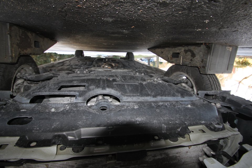

    Another option would be to remove the plastic skin under the car beneath the bumper to reach it from the back. That would mean jacking up your car and removing some screws under there and some plastic push-tabs. Once that is off, you could access the lower grill from behind as that's the only way to remove it from the bumper skin. The clips are only accessible from behind the grill.

    I saw the access plate... I migth try to make a pattern out of paper/cardboard before I do that. I though about using my car ramps, (rhino ramps) rather than jacks not sure the prius could get up those with out scraping.

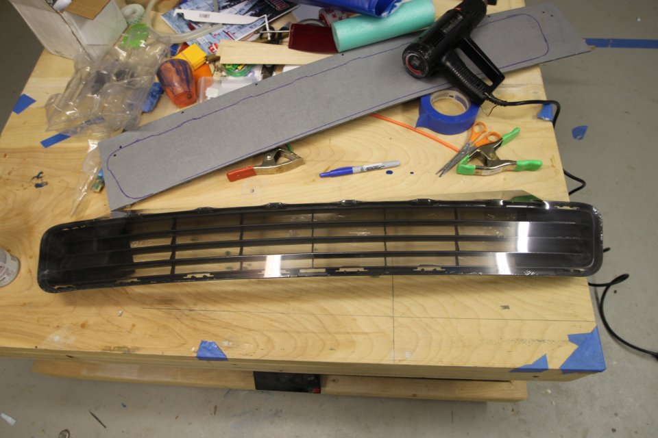

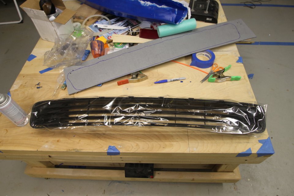

    Nice thing about removing the grill is that I could get a much better pattern. IE vacuum bag the carbon over the front.of the grille for a real nice final fit/finish
    I have some 5.7ounce carbon twill on a roll from a model I was building and more than enough epoxy to try it... I figure I coudl do one layer of glass for the back side with the carbon on the front. it looks like there is enough of a gap to make tabs on the carbon and end up with a nice friction fit.

    I have a heated workshop for doing the carbon work. if I took it off friday after work. I'd be able to do the layup that night and be able to have it back on by sunday evening. that would give enough time for the carbon to cure, and remove it from the grill while its still a bit pliable

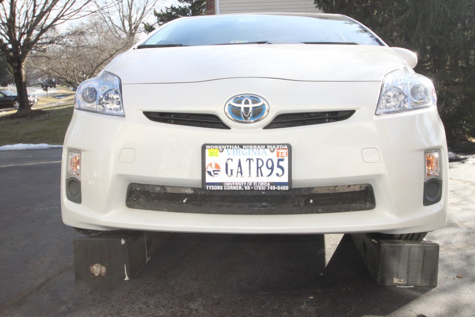

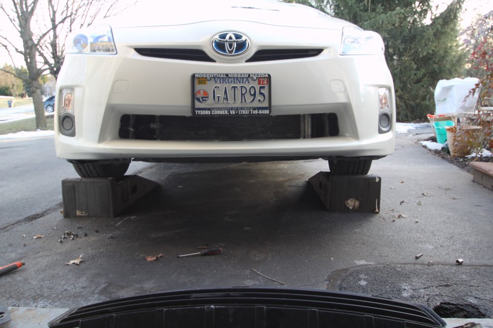

    good news... with the front under the bumper plate removed, you are able to persuade the lower grille to come out.
    i would highly recommend doing this when its warm out to allow the most flexibility in the bumper cover and the grill.

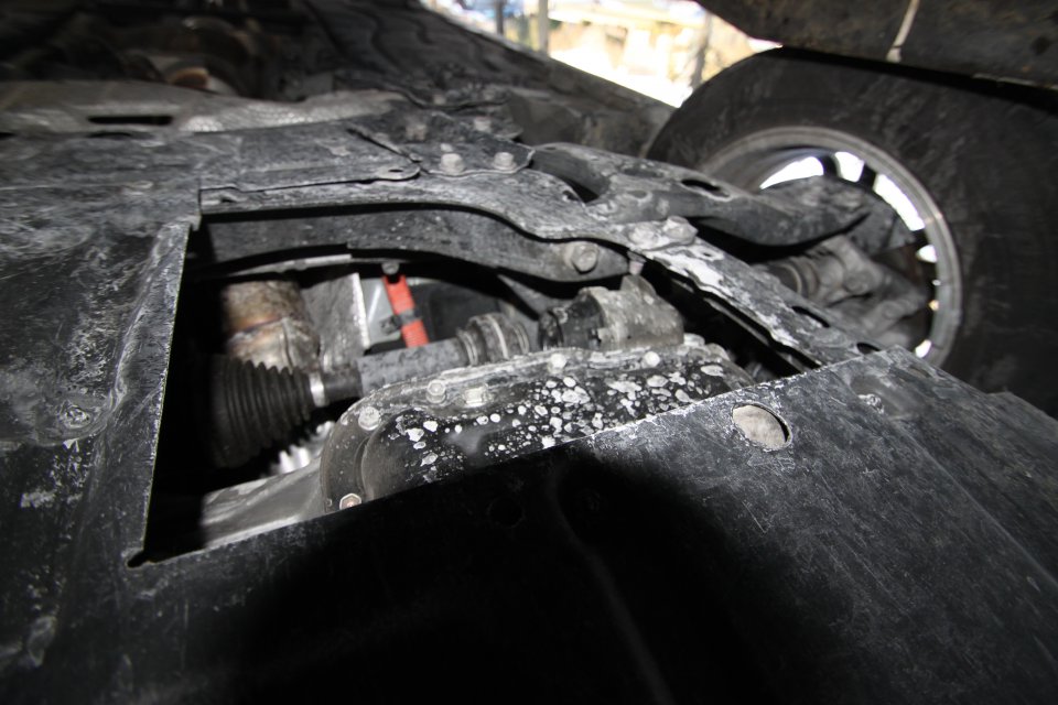

    on the bad news side. once I got under the car I notices the oil filter cover flap dohicky is missing...

    Good to hear you got the OEM grill out from the backside. Now you can fabricate the block more accurately. Yes, many have complained about the oil filter access door breaking from it's cheap hinge. So yours is totally missing? There are many threads here on how to remedy it.

    definitely MIA.... so I took some measurements I figure if I'm going to be mixing up some epoxy, might as well make one out of carbon and fiberglass. it'll be the trickest oil filter cover in the land...:) I'll just fab up a flat plate and head to the local hardware store and get a piano hinge... I have some 1/4" gray flat plastic, similar to what you'd find on a hard side suitcase. but I think it would be too heavy and would result in the plastic cover sagging.

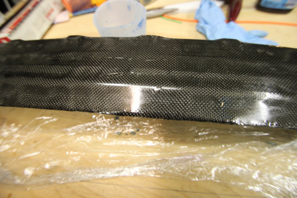

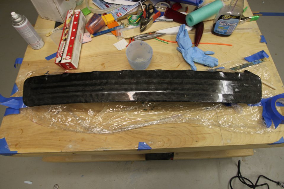

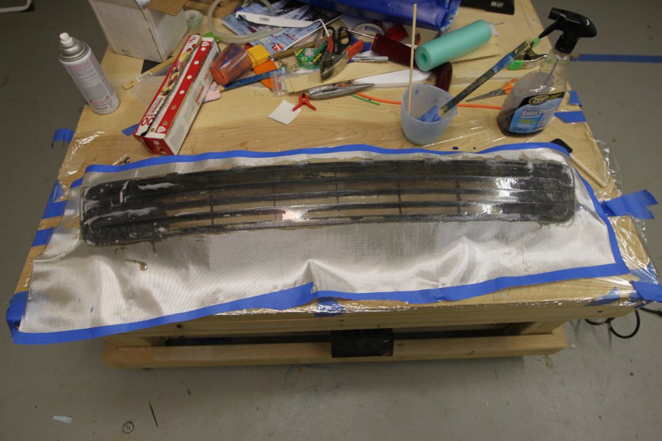

    .....one layer of glass and one layer of carbon...in 24 hours. it should be ready to come off the grill.
    phoenixgreg and DadofHedgehog like this.

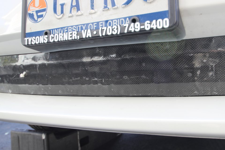

    ok so I cheaped out on the zeus fasteners... that might be worthy of a summer project. so for the short term I used zip ties. I had no black ones so I used white ones as pictured.
    I'm not happy with the finish of the carbon. it could use some more epoxy and sanding, just to make it pretty.. but it should be very effective.
