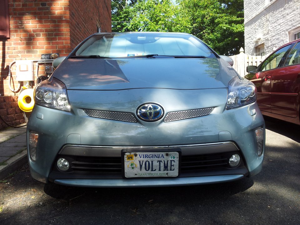

    I installed the top GrillCraft upper grilles on my PiP last month. I found there was nothing to cut away (and thus structurally weaken) if you take your sweet time on a warm Saturday. Just four guide holes to drill.
    My Advanced PiP's fog lights prevent use of the GrillCraft lower grille unless one were to cut circular holes for the fog lights in it. I now block the lower area with a light carbon fiber shield in the Winter, compliments to MarcSmith (above in the thread).
    Son's reaction: "Dad this car doesn't look like a Prius anymore".
    IMHO the GrillCraft silver paint works well with the PiP's front silver accent bar.

    Good job on your installation, DadofHedghog. As I look at your PiP's front end, it is very different than a 2010 II. Perhaps Toyota changed the inner structure on your car. Too bad Grillcraft doesn't make a lower grill with the holes for the fog lights. My lower grill looks great and has prevented many bugs and pebbles from making their way towards the condenser coils. I would do this mod over again in a heartbeat.

    IMHO the changes appear to be stylistic - certainly the shape & layout of the front bumper "skin" and some of the incidentals like the daytime running lights but not the underlying bones of the car.
    I thought about boring out two foglight holes in the GrillCraft mesh but then I decided to avoid the hassle of trying to match the nice GC paint. I even contacted GrillCraft and they wrote back that they aren't planning a PIp Advanced lower grille. Besides, that led me to MarcSmith's carbon fiber Winter airdam idea for the lower opening.
    Moreover, the way I (re)mounted my front license plate holder, its lower back hooks wouldn't work now with the GrillCraft. BTW I got that idea here on PChat.
